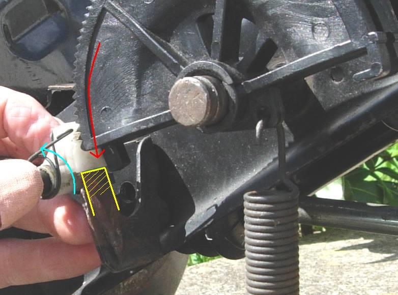

  3. Can't say for sure if it will fit yours. I have one on mine but don't use the sierra pedal box, thus needed the adjustable bit. You don't need the adjustable bit if using the sierra pedal box. Perhaps you would be better off with a sierra cable but try releasing the toothed pawl(blue in my pic). That allows you to rotate forward the quadrant, releasing slack into the cable which allows you to insert some spacer shims to take up the slack. Then try the clutch. You need to confirm that excessive cable length is the problem.
  4. Well that is very unusual. You have a bellhousing with facility for fitting the starter motor on left or right side. The starter cover is the lump of ally hiding the release lever. Are you are sure the cable is now in its proper place at both ends. If the auto-adjuster is working and the cable is the right length then the quadrant will not sit like the one in my picture (which is fully tight). It would sit with the quadrant partially rotated anti-clockwise in the view shown in my pic. If it sits like my pic then the cable is too long. You cant shorten the cable so you have to lengthen the cable outer. This is done with shims. They can be placed at either end of the cable outer. Or you can buy a new adjustable cable like the escort one shown below.
  5. There should be no problem, doubt or difficulty with the release bearing lever and getting the cable end into it. It realy should look just like the pic agent Z posted. As visible and accessible as a dogs balls. Yes the lever does stick out an inch. If yours doesn't then there is a problem with the lever. Secondly if your pedal box is assembled correctly the spring you just fitted will take up the clutch cable slack automaticaly. If it's not quite right then you can try lifting the pedal and that should work. If it hopelessly wrong then it won't. Second pic is the clutch with some bits stripped away. You can see the spring. You can see the toothed pawl (blue) that is lightly sprung and gets lifted out of engagement with the ratchet quadrant (red)by the post (yellow).

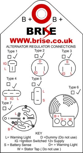

    It could be the regulator. rarely when that fails you can get normal battery light behaviour apart from glowing as you increase revs. But to help you need to identify the alternator, what connections it has and test each rather than guessing what it might be. Look at the picture below of the connectors and choose your alternator.

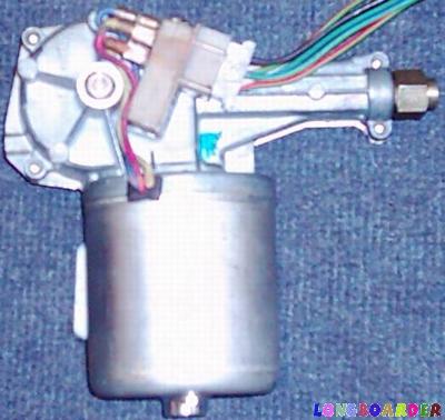

  13. pic will help with the wiring connections. As for the lubrication, the motor and both wiper spindles must be removed from the car in one assembly. The motor is usually held by a jubilee type clamp bolted round its barrel. The spindles pop up through the scuttle and have two nuts each, one to secure the wiper arm and one to secure the spindle. Remove these and the motor, bowden cable and spindle boxes should be loose under the scuttle.

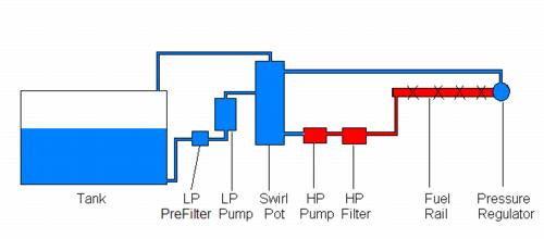

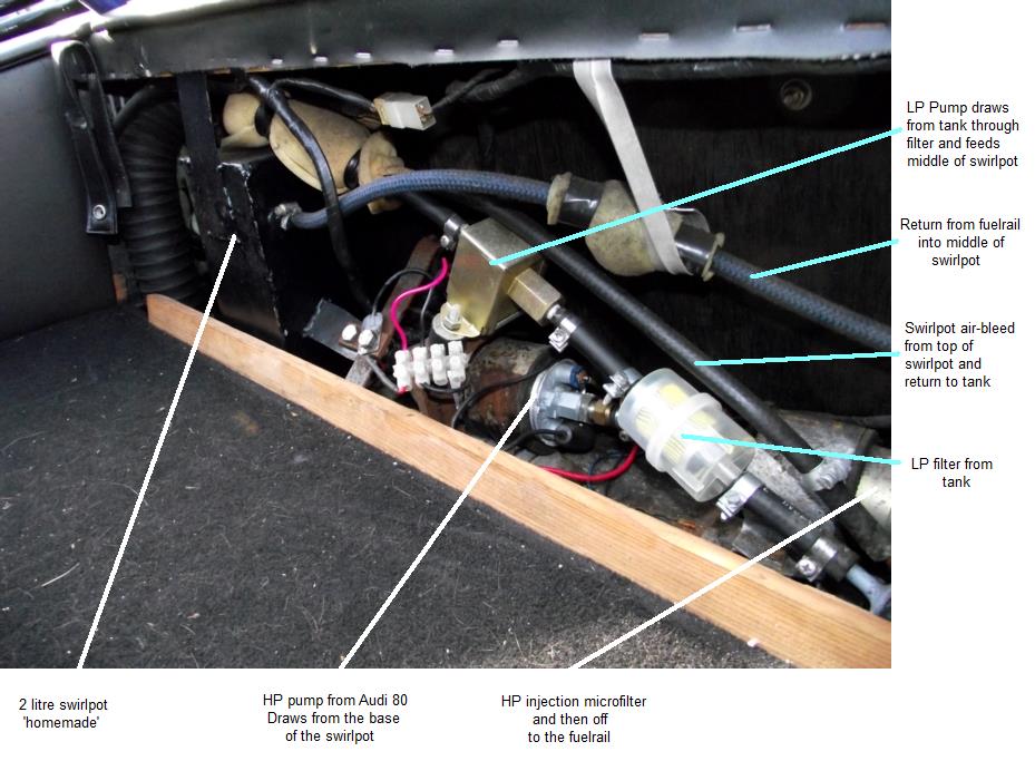

  16. To add to the mix I'm surprised at the anti two pumps and a swirlpot movement. There's space in the boot for all the bits. No idea why anyone would put them under the bonnet either. I use a cheap low pressure lift pump drawing through a cheap filter to fill the pot and a restricted return from the pot back into the tank. The HP pump draws from the base of the pot and then pumps through an injection filter and via 8mm copper to the rail and back in 6mm copper to the pot. It all fits in a six inch deep space behind the boot where it keeps cool. Looks like this and admittedly is fiddly to work on due to the space. Cost £70. I have had problems with blocked filters due to dirty petrol and have had to replace both pumps at the roadside. (But I carry spares)

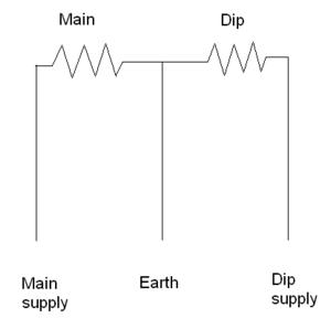

    Twin filiament bulbs? Check you have wired the left one correctly. As per the diagram below. If you don't get the earth on the correct terminal then either dip or main will have the two filiaments in series and thus not very bright and poor pattern.
