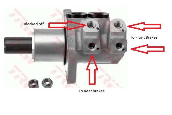

  3. my old setup was servo-less, i've done some research and i have probably got some air in the master cylinder, i didn't fit a bleed nipple to it just a pipe with some solider in the end, i'm just unsure if the pipes are in the right holes. mark
  4. bore size is 20.6 mm, all standard ford sierra brakes, discs front and drums on the rear, the peddle is solid, but when i brake its like they have brake fade, mark
  5. hi i have fitted a Fiat Punto master cylinder, i've bled the brakes and is no air in the system, test drove and the brakes are rubbish, do i have the pipes in the right place? Mark

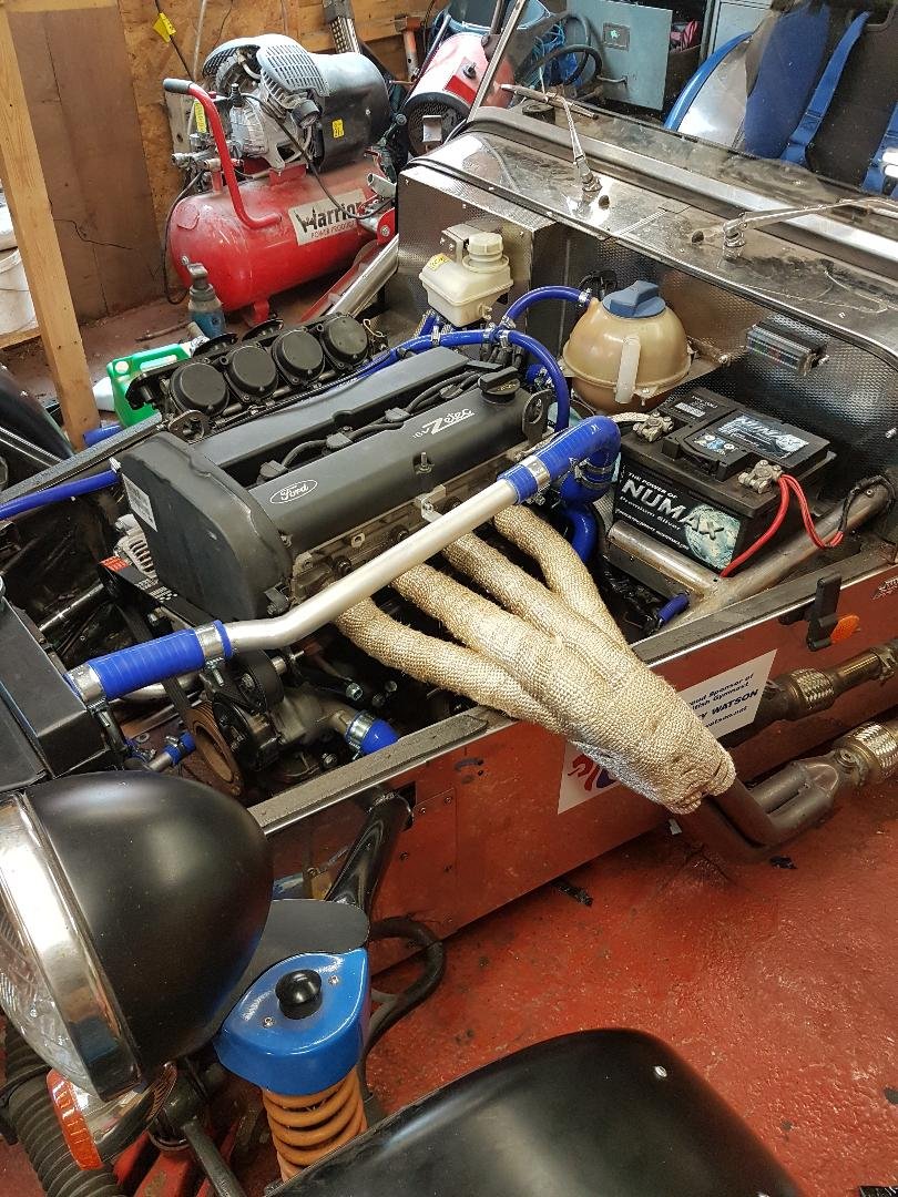

  13. bit of an update, only a few little jobs to do and its ready for the open road....

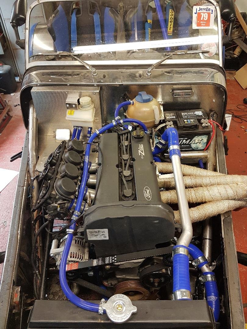

  14. Hi, Going bike carbs with megajolt, had the engine running this weekend, really pleased with the progress. Cheers....
