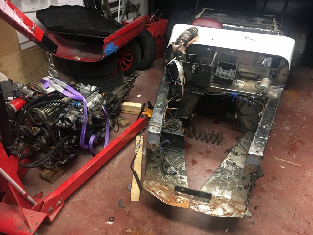

I was hoping I'd be posting another update video this week, but I wont be, and this meme sums up why
44518036_2072300769489371_73121972274876
Feelin ya. Started a simple small job this week and have a list now....
