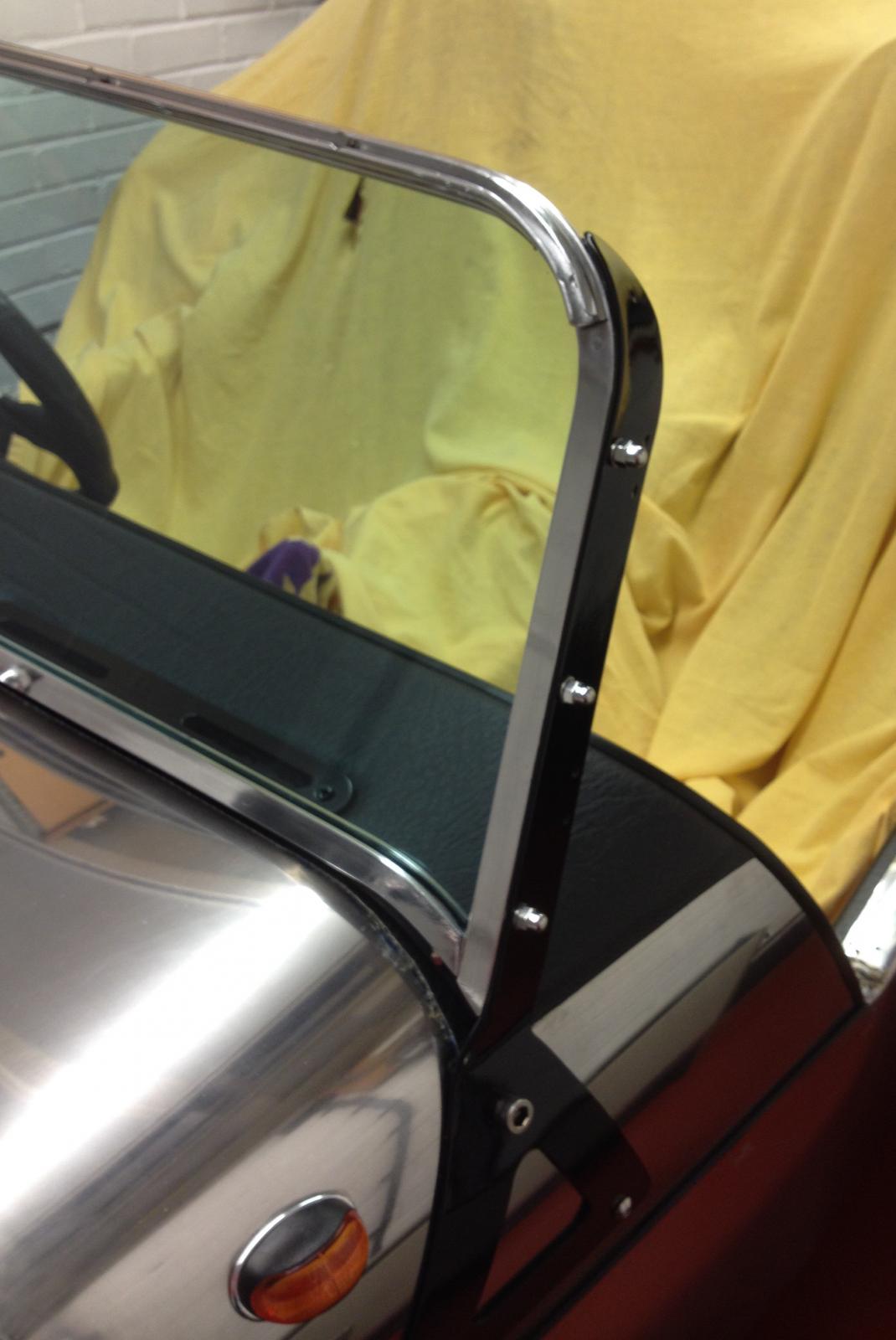

I used m6 hex head bolts with the heads turned down to about 2mm thick (from memory) inserted into the channel with the thread sticking through the screen supports. Finished with dome head stainless nuts. There is also a supporting strip welded at the back of the supports to give more support to the screen
I used m6 hex head bolts with the heads turned down to about 2mm thick (from memory) inserted into the channel with the thread sticking through the screen supports. Finished with dome head stainless nuts. There is also a supporting strip welded at the back of the supports to give more support to the screen. Photo during rebuild:
I also used M6 bolts but instead of going from the inside outwards i drilled and tapped the alloy frame to accept the bolts. So i have 3 button head hex bolts instead of the tiny self tappers.

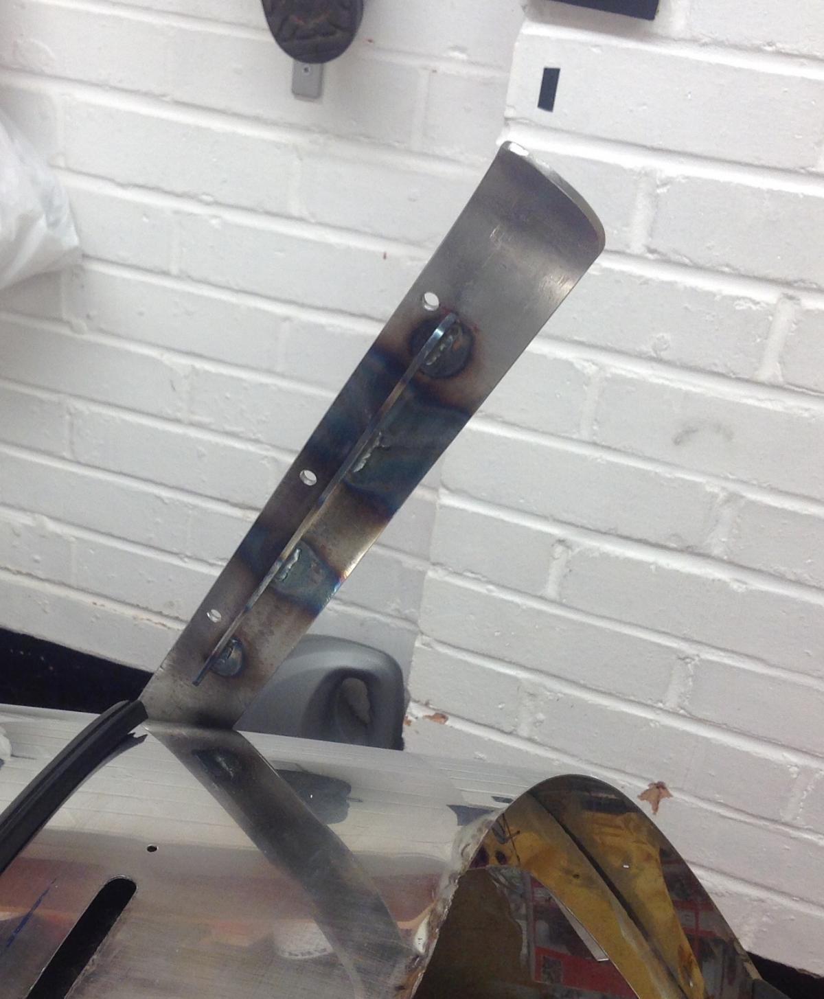

Ideally it would be beneficial to weld a strip of steel down the windscreen pillar to prevent the windscreen being pushed back in an accident. I would have done this but i welded threaded lugs on to accept bolts for my door hinges which i guess do similar.
I drive through the forest where deer live so my main concern is the windscreen stopping a deer coming up the bonnet at me. I have considered creating a steel rollbar just behind the windscreen bolted to the chassis for this reason.
hth
My reinforcing strip. (Not a very good photo)
