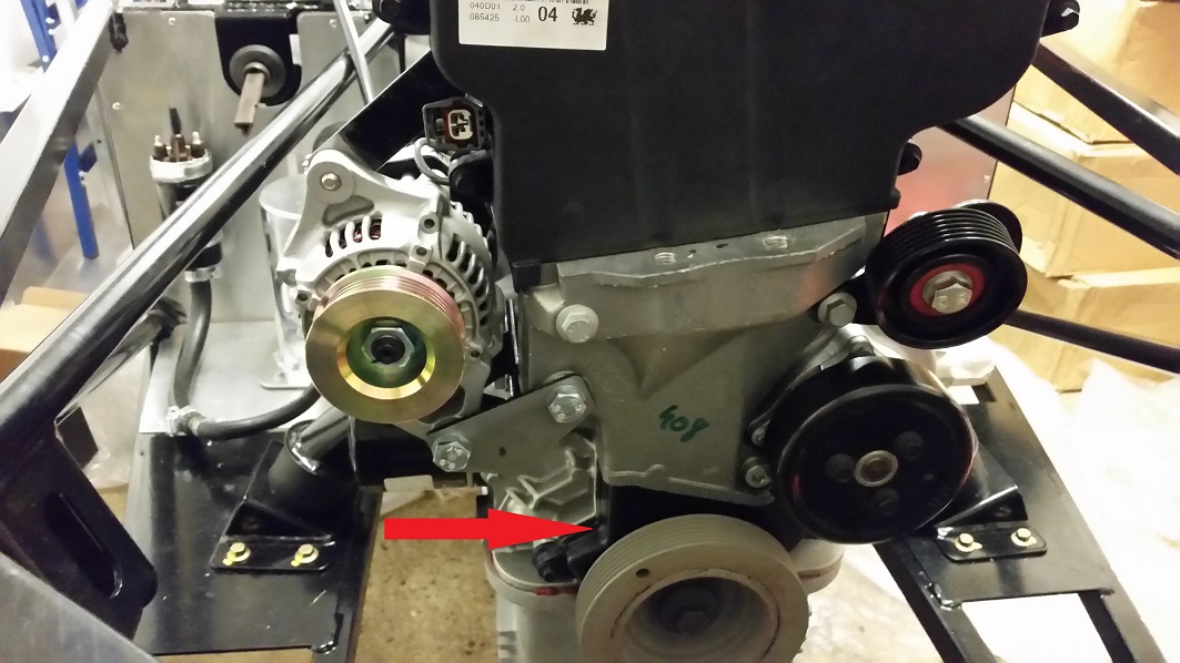

Next step is to check the oil pump and YouTube has, amazingly, let me down - no (useful) videos of how to get it off. Anyone suggest a good video/source of explanation?
I'm most concerned about my ability to get that front flywheel (?) off as I don't have an air gun - is that going to be as hard as I imagine? Do I need to take everything off the front of the engine (water pump as well?) or is the oil pump just the black bit behind that flywheel (red arrow in attached pic)?
Any help/suggestions appreciated...
Edited by nelmo
That front flywheel is the crank pulley and if the engine is still attached to gearbox then put it in first gear and and make sure hand brake is well on then you should be able to undo it with a breaker bar
That would make for a f**king strong handbrake :)
Might want someone to stand on the brake pedal while you're at it, nelmo! Or else lock off the flywheel ring gear into the block with a suitable large flat blade screwdriver or proper locking tool - but just be very, very careful that if you go this route you are putting it into a part of the block with some strength, not a little tab sticking out that will snap off under the torque ;)
