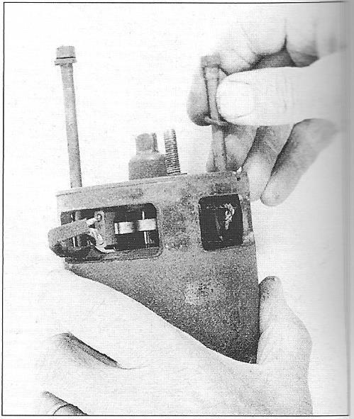

Most starters (in the olden days) had two long screws which hold/clamp the end plates onto the central body. Usually the slotted screw heads are on the 'free' end and the screw threads into the plate at the bellhousing end. They should be very tight. Impact screwdriver often needed to undo them. Loose is 'not right'! Tight as you can.

My starter motor is a Lucas one - there were no visible nuts to tighten and the only bolt heads were rock solid (I've also since spoken to a Ford mechanic who doesn't think the rattle is the starter motor).
