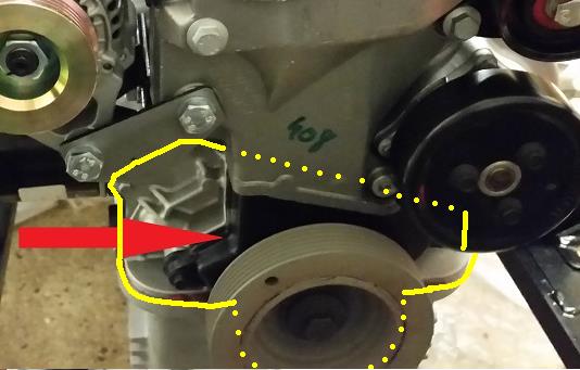

The red arrowed black bit is the lower cam belt cover but it is bolted to the oil pump. Oil pump sits round the front of the crank,and is ally. With the sump off a lump of wood between the crank and the block should stop it rotating as you remove the crank pulley bolt, pulley, cam belt drive sprocket and so on to get to the oil pump housing.
Having said that I think you're on a wild goose chase having failed to identify a rattle which with a non running engine you can't now reproduce. I've never heard an oil pump rattle. Its full of oil and running direct of the crank, no gears. If it tried to make a noise the oil would damp it. I would put the sump back on ( having increased the bend in the scraper plate or even hacked off 5mm each side). Put oil and water back in it and continue hunting the rattle until someone has a good idea where it's coming from. For instance have you run it without the alternator belt to rule out the alternator and water pump. Been round the alternator mountings water pump mountings, and idler pulley bolt? Run it with the cam belt covers off to see the tensioner and idler pulleys at work? You have to have a good idea of whats making the noise before you strip down.
