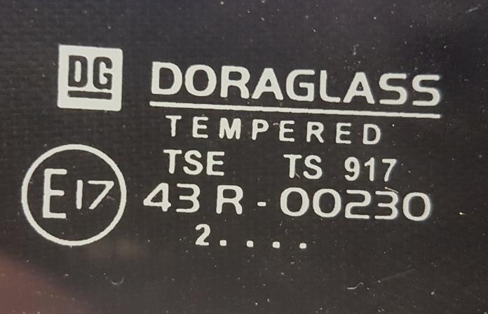

I am coming to the end of the build of my Robin Hood 2B and I am just in the process of fitting the windscreen. I have read numerous threads and the IVA manual and just want to confirm a couple of things.
These are the markings on my windscreen...
Am I correct in thinking that this won't get through the IVA because of the missing Roman numerals above the E?
If I remove the windscreen, wipers, heater and washers and get it through the IVA would it be a bad idea to fit it anyway because it would be too dangerous?
Thanks
Graeme

You've probably seen it, but this was a thread I raised before I built...
http://www.rhocar.org/index.php?showtopic=41972
I agree, it's missing the numerals, but it does have TEMPERED written on it clearly. And, for what it's worth, on my IVA I never noticed the tester take a long hard look at the marking anyway. Given it's almost a mandatory 1st fail on IVA anyway, I'd be tempted to run with it as-is and if it fails you can remove the glass as a template and get one made up with the correct markings, refit and retest.

None of the windscreens from RH will pass the IVA as they are not laminated and don't have the // symbol. Pilkingtons should have the template for the RH 2B as I sent it to them and bought a screen. was around £250. might be cheaper now they have the template.
