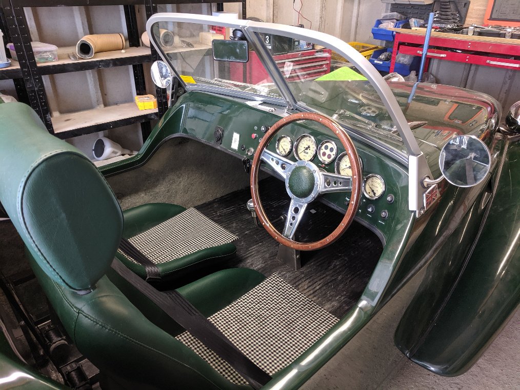

Still - that is very helpful.  Did you detect any leeway on any items - for example, height of headrests/exhaust standing proud of the rear / need for repeaters ie angles carefully checked?

Well looking at that pic and being as strict as I can be (ie. worst case; please forgive me!) I would feed back :
  • Rear view mirror not permanent; will definately fail
  • Can't make out radius on centre of steering wheel and bolt heads but could be an issue, certainly doesn't look very soft!
  • Ignition key will fail
  • I can't see any demister vents to the screen, unless the screen is heated electrically maybe?
Otherwise looks pretty good, assume all the windscreen edges and dash are radiused
edit: you should probably start your own thread, save us cluttering up daniel's ;)
