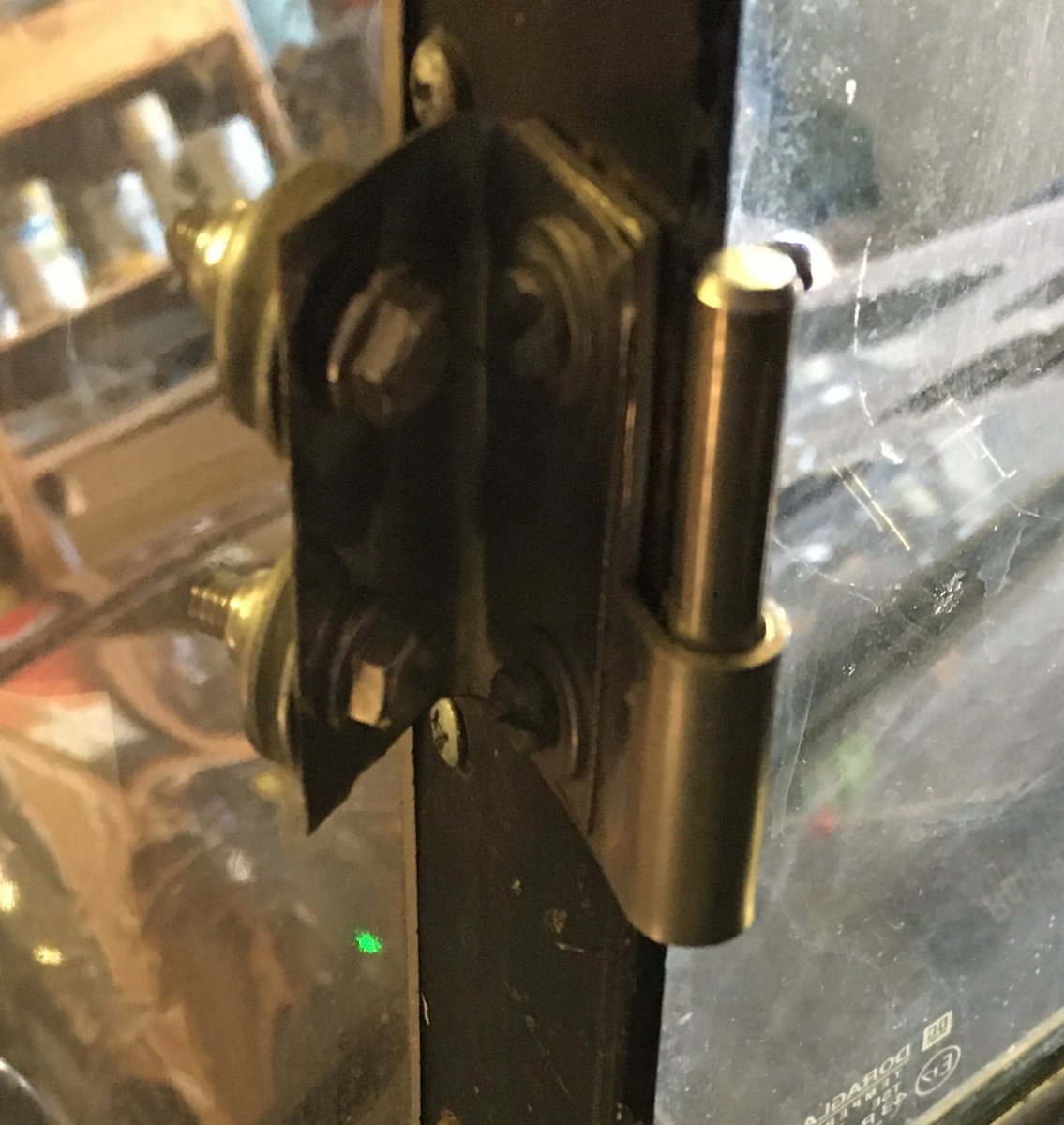

Did you not have the original door hinges ?   I simply fabricated some brackets from stainless steel and put them on the same bolts as the original door hinge so I could continue to put the doors on if required.
That's an idea Alan

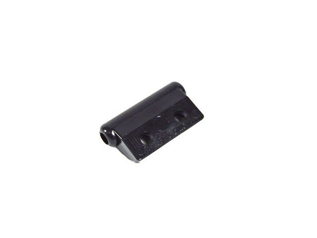

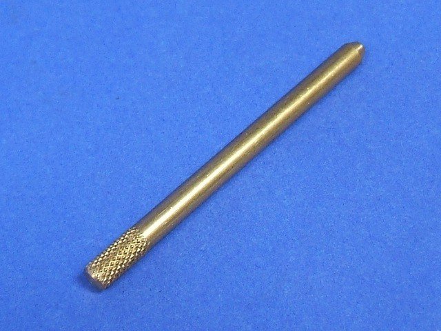

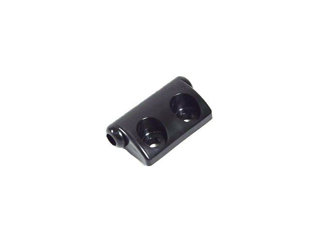

I purchased a pair of Caterham wind deflectors from ebay at a good price.
Then purchased the hinges from Caterham part no's as below.
Hinge pin sidescreen 76226 £1.88 inc vat
Hinge sidescreen        76225 £0.68 inc vat
Note you will need 4-pins and 8-hinge parts to fit the doors or wind deflectors.

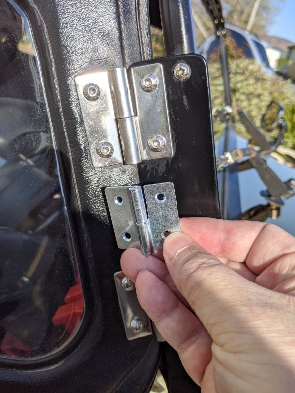

When I had my Dutton many years ago I bought some normal hinges the correct size from B&Q well it wouldn't have been them as they didn't exist, but somebody like them, ground the top of the pin off so they came apart like the ones in the images

I also used
https://www.ebay.co.uk/itm/181024489629?var=480201565867
https://www.ebay.co.uk/itm/160881328576?var=460114933842
Along with some 3mm washers to replace the metal parts of the hinges & then some 4mm countersunk bolts, washers & nylocks to fasten them to my frame
Then
2 pieces of https://www.ebay.co.uk/itm/282151591925?var=586287413267 to make the actual screens, but mine is not on a RH so you may have to improvise,
