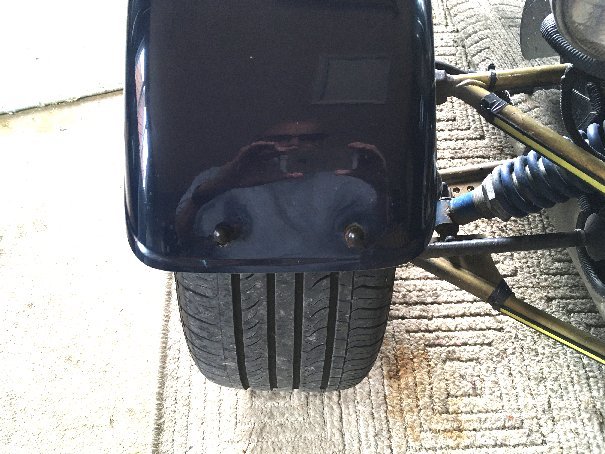

Much as I love sikaflex, I didn't want to entrust it so went with rivnuts, stainless domed bolts and chassis padding underneath :

This is what I did albeit with one rivnut and bolt. I also silkaflexed for a belt and braces finish.
Yeah... one would probably do. I'd also recommend you don't do them up tight unless you want the gelcoat cracking - I used lots of threadlock and "just nipped them up", if you get my drift.
