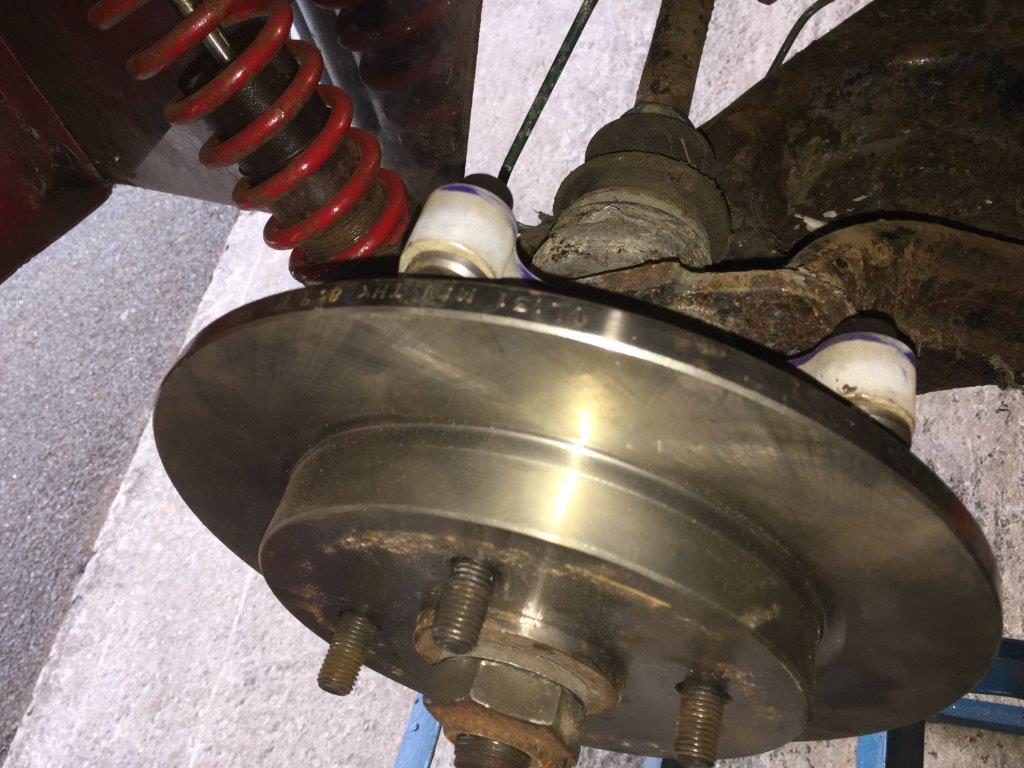

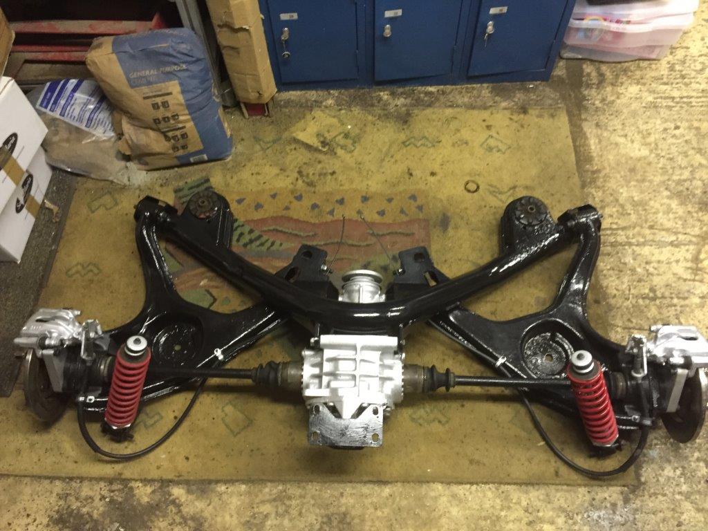

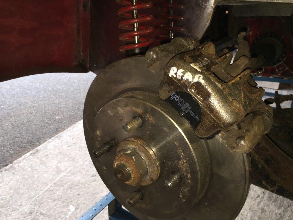

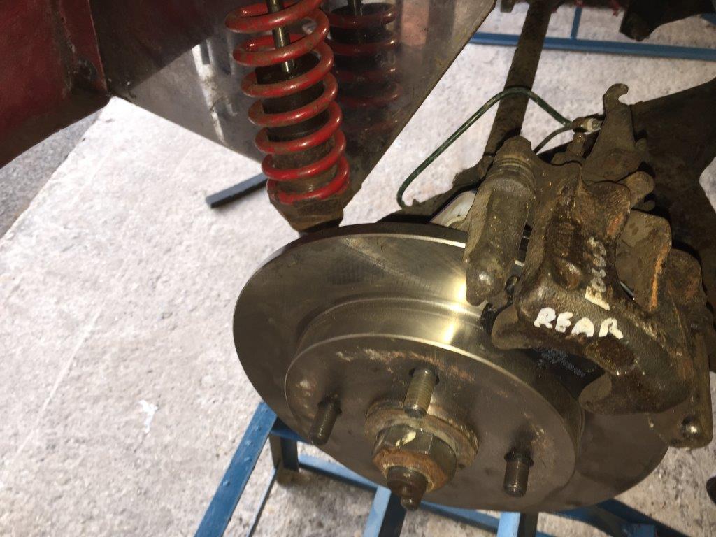

  13. Mine had 9" drums & I just used the hubs that were already fitted. I did change the studs to slightly longer ones as the disc is slightly thicker than the drum & also I have alloys - Focus again, the donor had steels. I'm running braided hoses - made to suit at work & the handbrake cable is a shortened/modified focus one with cables routed from behind..
  14. Pics uploaded
  15. I've done it, but went down a slightly different route & had some caliper adaptor brackets machined at work as I decided not to use sierra parts due to the 'cosworth' tax & used focus parts instead (fraction of the price, parts still current so easily available & they are actually the same discs used on the sierra anyway). I will try & post some pics later as I'm struggling to get them to upload at the moment. Rich

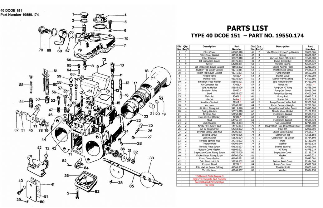

    Which part is it on the attached diagram? Do you meant No4? I have a spare one of those. Rich
