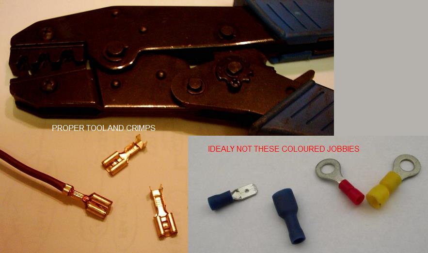

A word of caution about soldering versus crimping for making joints. Jury's still out on this one.
Most joins in major manufacturers looms are crimped using proper double hold crimps (pair to hold the insulation and a pair to hold/electrically connect the wire.). Insulation added after with heat shrink. (I personally favour this method.)
Soldering a crimped joint does seem to offer extra hold and extra electrical contact/lower resistance. However it also seems to increase likelihood of fatigue fracture in the longterm and it's difficult to locate the break when it's all wrapped up in the loom.
My loom is 16 years since registration and no electrical failures from the crimps. (I have had failed electrical components and one failed soldered joint which was a splice in the loom).
Nigel
Crimps must be as below. Not chocolate blocks, scotchlocks or the coloured thick plastic coated crimps. All work for a while before introducing failures.

Sorry Nigel I am going to disappoint throughout with the type of crimps I am using :( I understand the point however we have used them at work on the electric cars and not seen any issues (yet). All connections are given a very firm tug test once done, I'd much rather they fail now than on the car!
