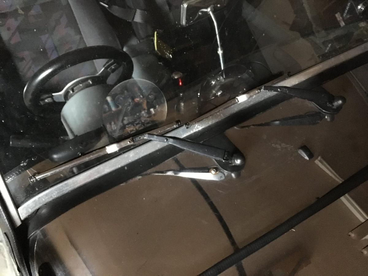

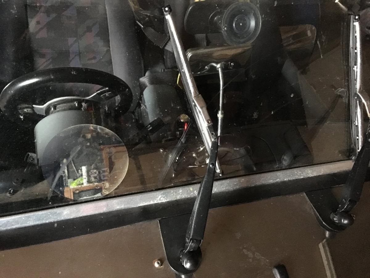

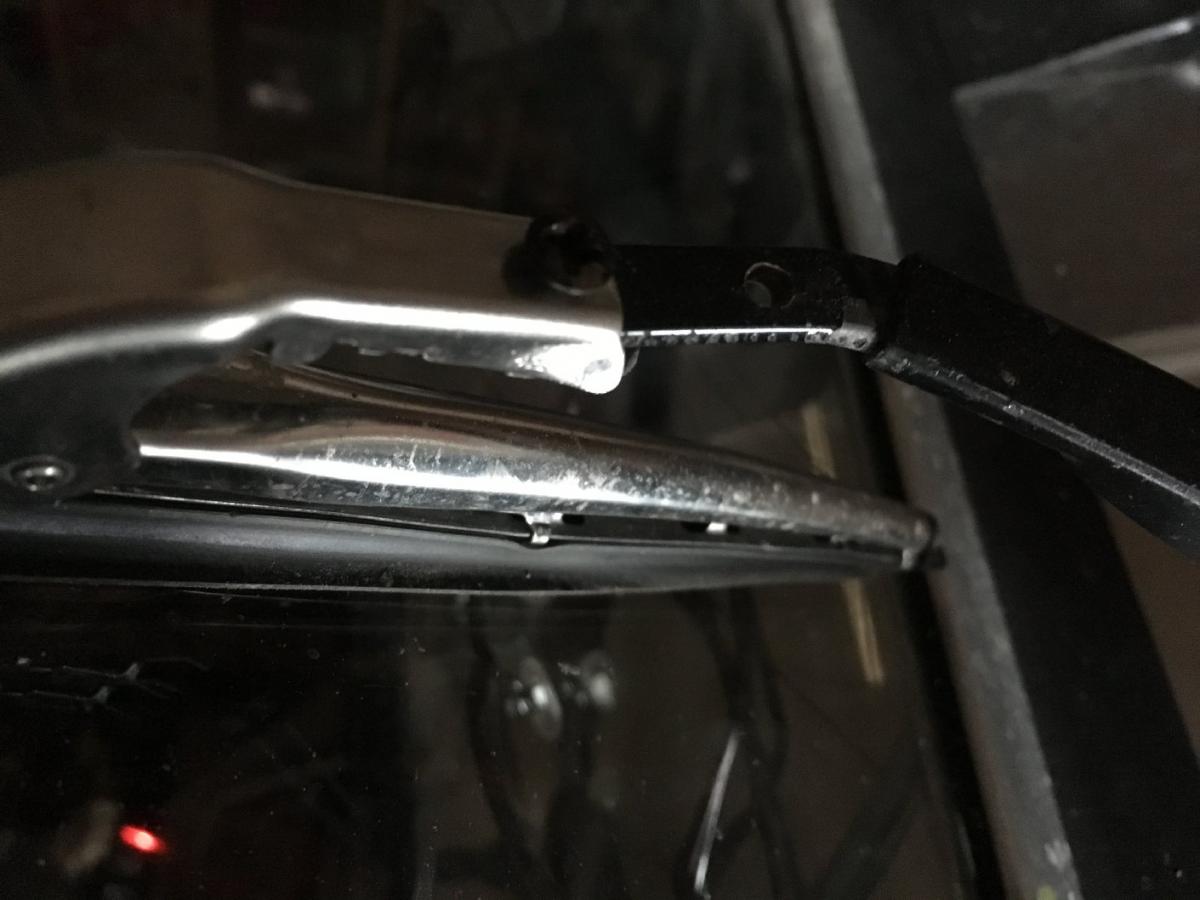

I managed to get 10" ones on mine. The biggest problem was getting some with the correct bayonet fitting to fit on the current arms. I finished up resorting to the angle grinder.
post-12714-0-79060800-1524812517_thumb.jpg post-12714-0-47992800-1524812535_thumb.jpg post-12714-0-21077700-1524812553_thumb.jpg
Wipers just take a bit of time and fiddling to get right, lots of time spent positioning where the spindles come out (nothing you can do about that now, mind) and then working out and cutting the arms and the blade to the right length. You'll also need to bend the wiper arms, the metal parts, by putting a twist in them to make sure the blade sits as close to square on the screen as you can get, so that it wipes efficiently. But, having said all of this, these cars aren't the best for windscreen shape and wiper clearing pattern ;) so some degree of.... how to put it... "reduced expectations" :D.... is normal :) ;)

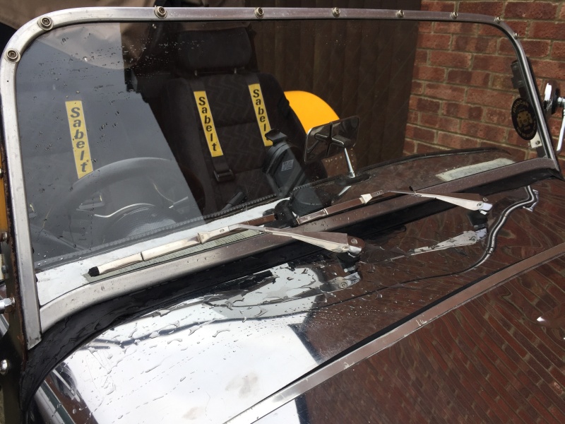

My arms and wipers came from Car Builder Solutions. Pic attached in the park position if you can judge the arcs from that.
