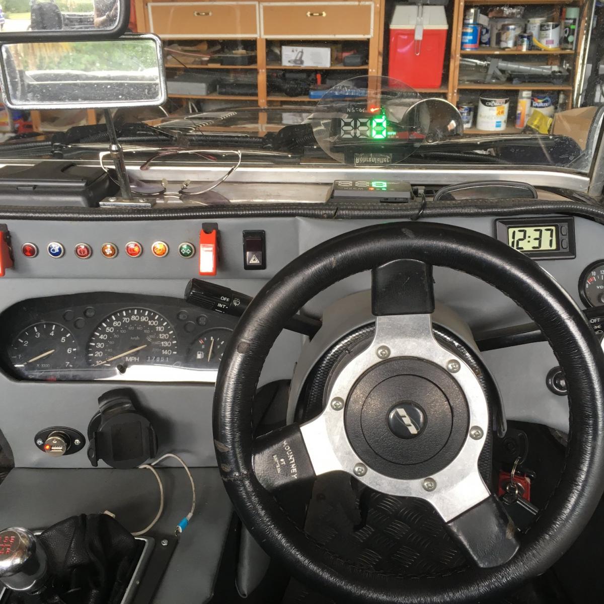

GPS Speedo on mine. It's standalone, doesn't require any installation, magnets, sensors. Easy :)
What is the make & model , Alan?
It's a Chinese no name one from E-Bay that just sits on the scuttle and provides a heads up display on the windscreen. I bought it as an emergency replacement when my speedo cable snapped just before last years's MOT. But it turned out to be so good that I now use it as my main speedo. The only downside is that it doesn't include an odometer.
See https://www.ebay.co.uk/itm/GPS-HUD-Digital-HeadUpDisplay-Car-Truck-Speedometer-Warning-Navigator-/282922852045?hash=item41df841ecd
As a temporary measure I used a speedo app on my wife's phone. Worked well but could have a slight delay depending (I believe) on satellite coverage
