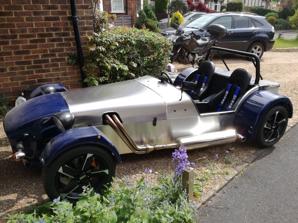

I had holes drilled for the wipers and just fitted rubber grommets to fill them in for the test - ditto for the windscreen bracket holes (below is how I went to IVA) :
Your Zero appears to lack demister slots which I thought were already cut on 2B's along with the wiper holes, so a bit more to fill in prior to IVA.
No bonnet vents either on the Zero models?
I managed a first time pass with windscreen fitted. I did need to make a small correction to mirror positions. I think the key is to present a car that looks properly finished and ready to use. When I was there a manufacturer was retesting a failed car and to be honest it looked thrown together.
