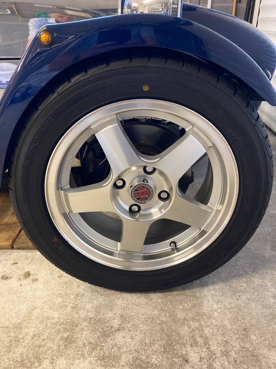

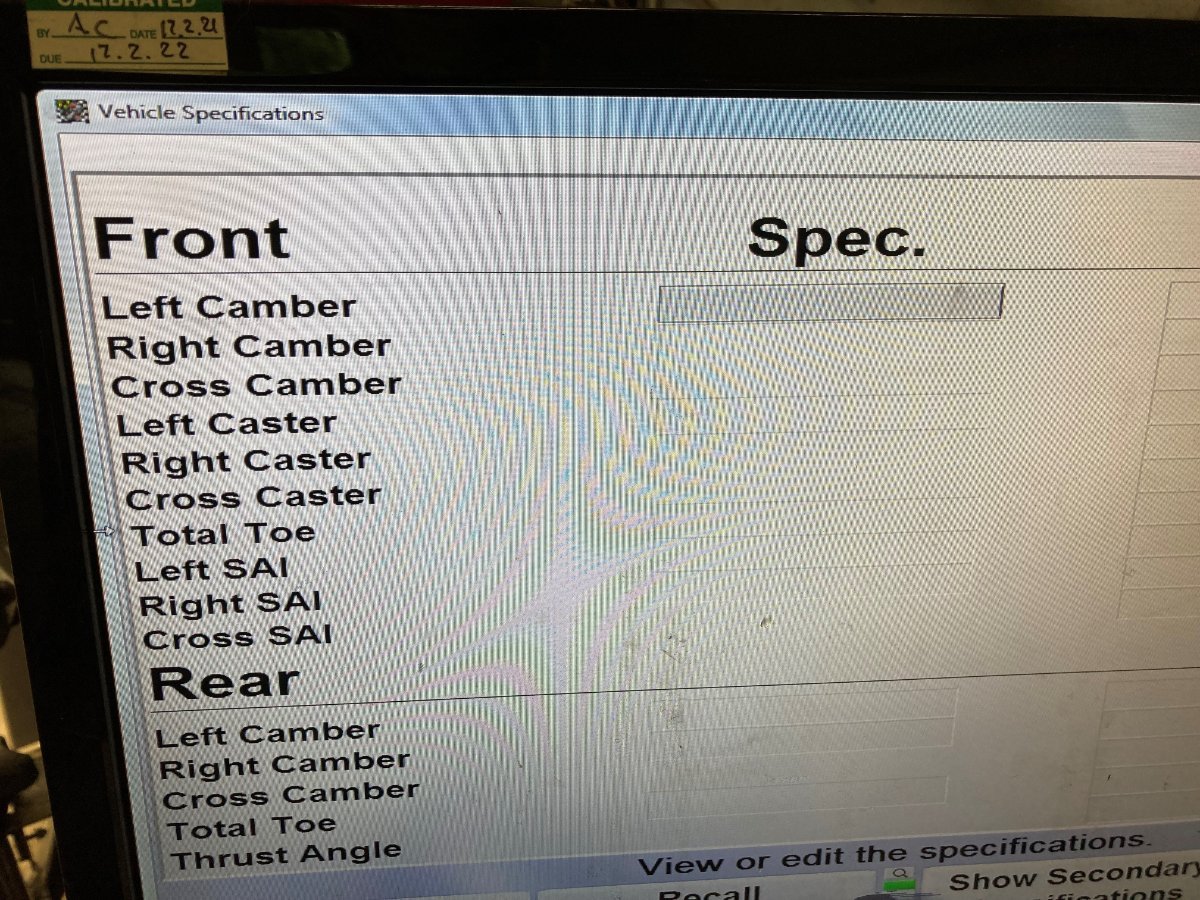

Any advice would be welcomed on getting front wheel Aligment carried out with glued on GBS mudguards as there is not enough clearance to fit 'Hang on' type eqipment.
Advised there is an alternative system that fits onto the wheel, however, it requires a lot of details I dont have. Recommendations would be much appreciated.
GBS have told me 1.5 degrees negative camber
Tracking parrel but if it feels as if it wonders add a little toe in
and 18-22 PSI in the tyres.
