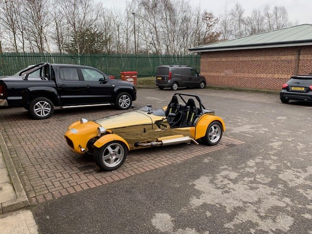

    Finally after 12+ years, she is complete and registered. Had its maiden voyage today. i find it hard to believe these cars are road legal. Before its next trip I have to raise it a little as the sump guard caught a couple of times. Wow, that was fun. Thanks for the help over the years. Jeremy

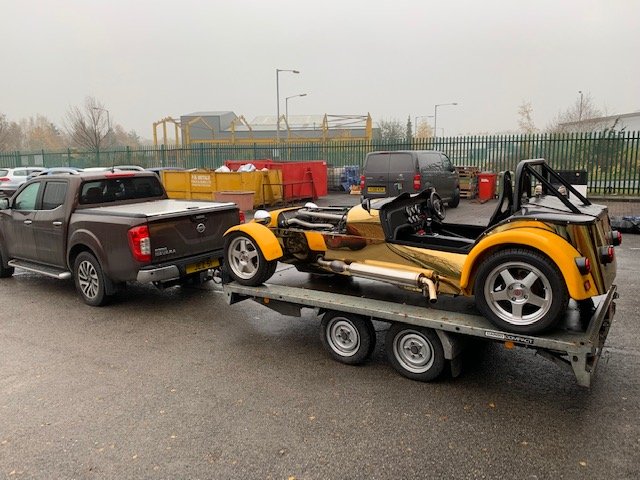

    I didn’t know the GBSC route was so popular until I tried to book it. Been wait months for the booking. The other reason is I took it there is it’s only 30 minutes away thanks for the comments
  23. jmspec
    Nearly ready
    After to many years the car is nearly finished. I have booked it in to GBSC to get it through the IVA. I know its a bit of a cop out at this stage, but work seems to get in the way so much and I don't want the build to stall yet again. I hope they don't find too much wrong as I feel I have done a decent job. My main problem will be that I haven't followed the IVA spec to closely, just built it as I think it should be. Fingers crossed. Jeremy
