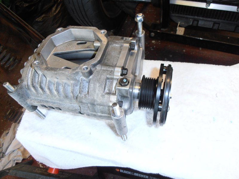

The first job is to fit a new pulley to the supercharger. The Eaton mp62 comes with an electromagnetic clutch operated drive pulley, however this is very large in diameter (approx 90mm) and when coupled with the zetec crank pulley (126mm dia) makes for a very poor pulley ratio.
60mm dia pulleys are easy to get hold of on eBay for less than a tenner, however Dan found a 55mm pulley in his 'box of bits' so we've used that......running the pulley diameters through my calculator, I estimate around 7-8psi of boost.
The supercharger drive shaft has a very fine spline, so the hub from the clutch pulley has to be removed, machined and fitted into the smaller pulley.

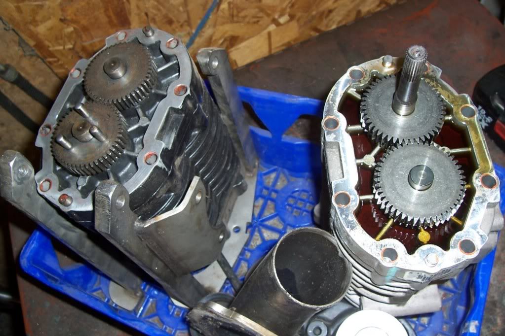

Guest old_timbo
Yes, I was worried about the strength of the drive shaft with the long over hang, also the extra load it would put on the main rotor bearings. On most Eatons they have a separate shaft running in bearings in the drive nose that takes all the belt load from the drive and this has drive pegs between it and a rotor gear. Hence little load on the rotor bearing. In the US they have M62s without clutches. See photo of the two types.
