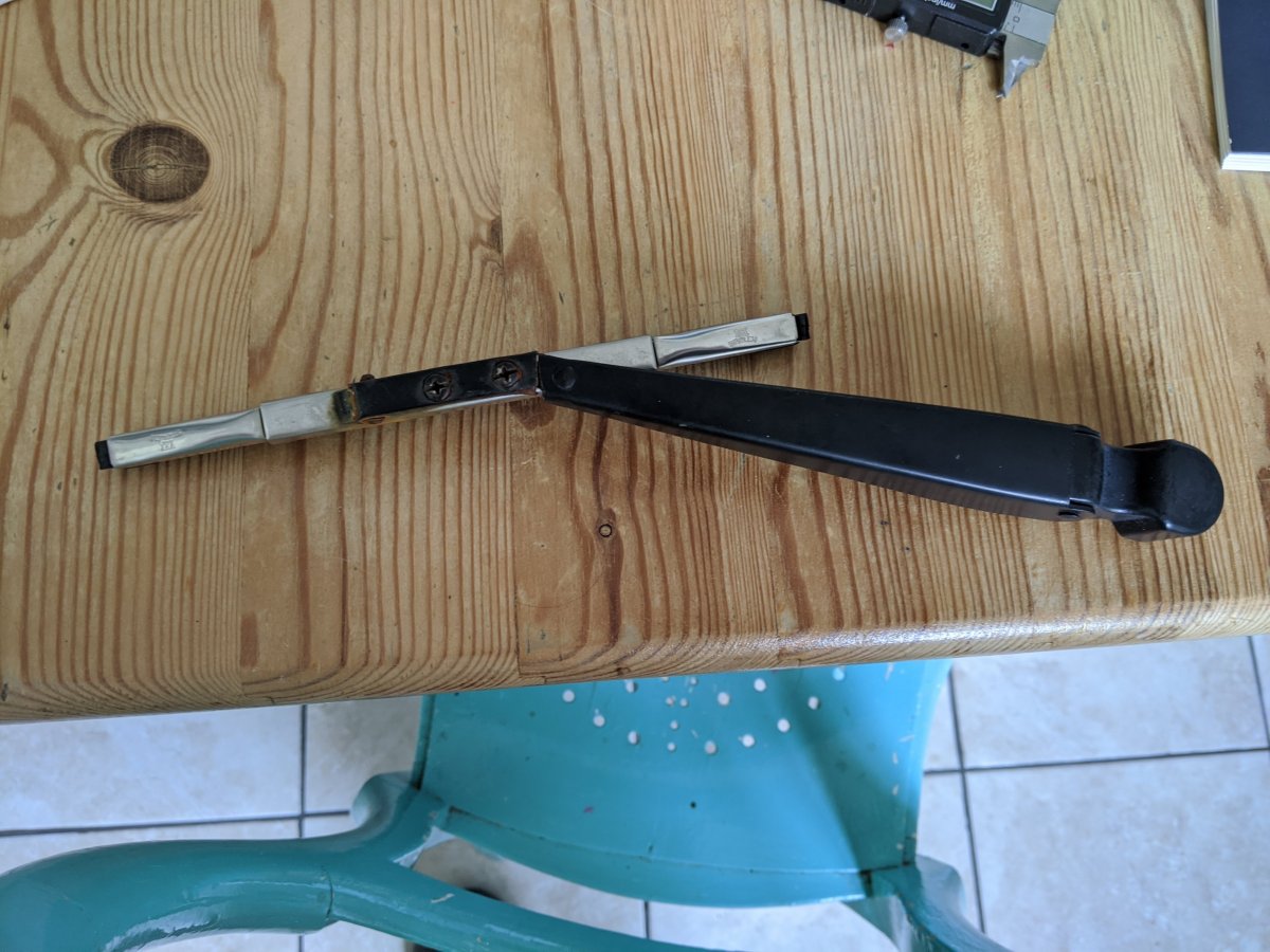

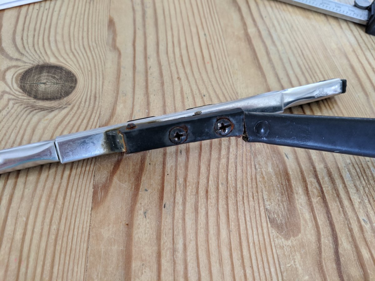

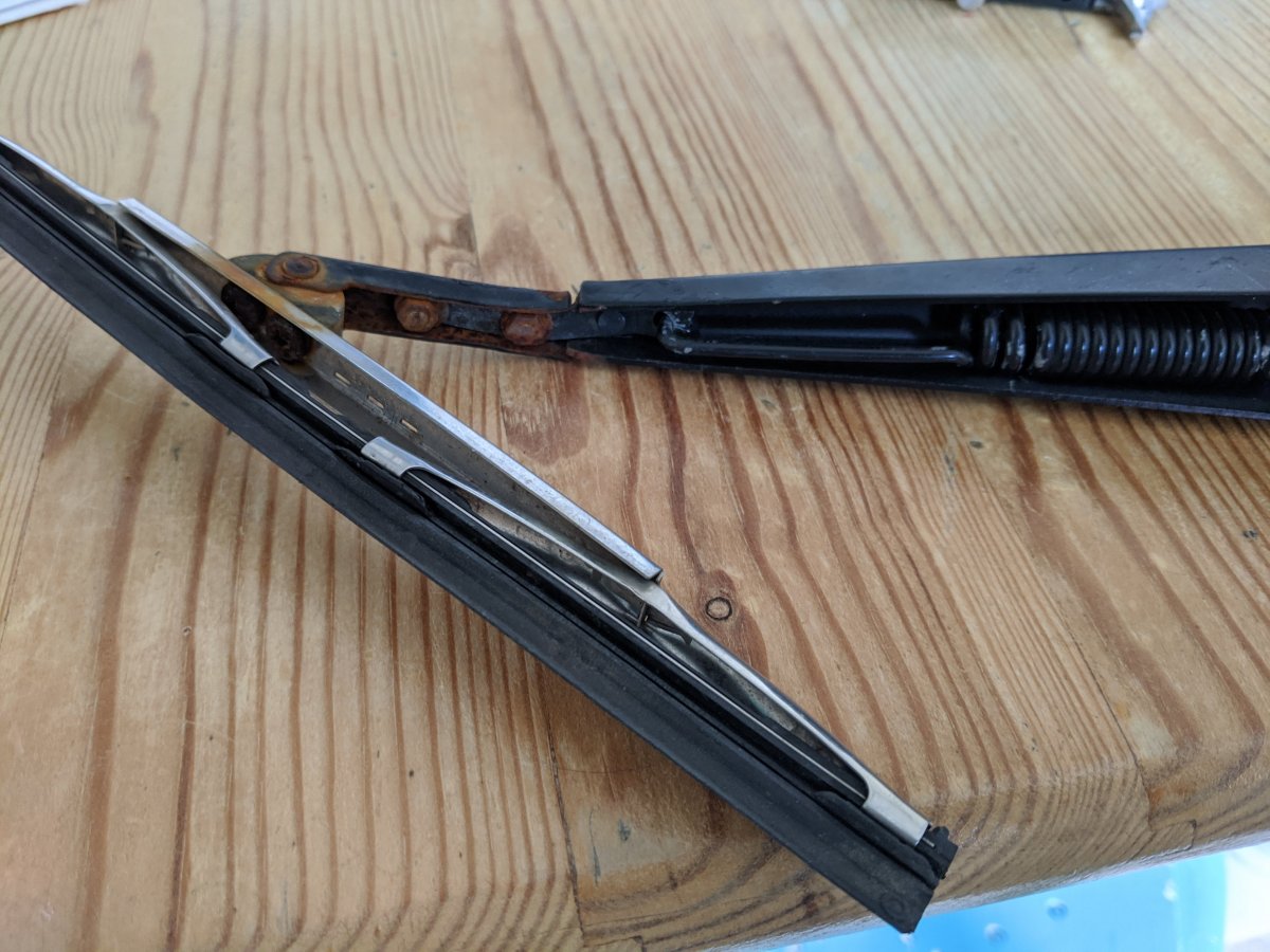

I’ve just finally fettled my wipers today which were held on to the arms with 2 little screws. I’ve heated and bent the arms to fit nicely to the screen and went to change the wiper rubber as mine were old but actually discovered that when getting a 18” universal wiper of the shelf in the garage I could cut this in half to create to 9” blades and the Blade arm was slotted which actually lined up to the screw Holes in the main arm perfectly. Can take a photo tomorrow if needed.
  • Thanks 1
Yes plz
Thanks to Mike for his suggestion of using an 18" blade and cutting it, worked a bloody treat especially as blades have slots in the metal frame so easy to adjust
It happened to be a spare on the shelf I think I may have to go and purchase Another to keep as a back up now.
