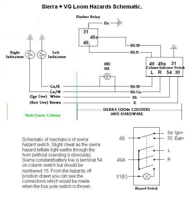

  13. Been away hunting the sun. GBS looms are plug and pray. I don't know how they test them or if! Basic info and you will then have to work from there. Hazards use a constant live supply into the column plug pin 30. Indicators use an ignition live supply into the column plug pin 54. If the hazard switch is ON a constant live goes out from column pin 49 to indicator relay pin 49. If the hazards are OFF (and ignition is on!) an ignition live supply goes out from column pin 49 to relay pin 49. If hazards are off and ignition is off pins 49 will be zero volts. This is regardless of what's going on 'downstream' of the relay. (Testing relay output from pin 49a is problematic as some relays will not function without the correct load. More modern relays are not load dependant.) (The relay also has an earth pin 31.) Potential output from relay pin 49a returns to the column switch pin 49a and goes nowhere unless the indicator is used to send it to L or R circuits which of course are separate. When the hazards are switched on supply to the relay pin 49 is switched from ignition live to constant live, L and R indicator circuits are linked together and output from pin 49a is switched to both these now linked circuits. Found an old pic with Sierra and VickiGreen colours which may not be your colours but the circuits should still be the same. If all the indicator lights flash with hazards ON the relay is probably OK. Hazard switches have been sticky in the past so some contact cleaner or WD40 might help. It does sound as if ignition live output from column pin 49 may be suspect. Check column pin 54 is live with the ignition ON. Early switches part numbers start 83BG and later ones 87BG or 92BG but I don't think it matters in this case unless the pin layouts are different. Relevant pin numbers are the same.

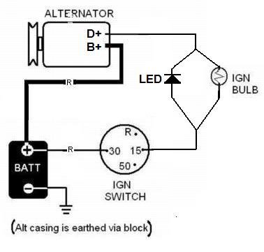

  17. Type six needs more excitatory current to terminal D+ than an LED can supply, even if the LED is the right way round! Thus as has been suggested you need to run a resistor in parallel with the LED. A suitable resistor is an old fashioned ignition light bulb, 12v 5w. Crude pic below.

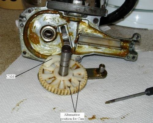

  18. The park switch unclips from the wiper body and disassembles too.
  19. You can just see the cam in the picture. You can also see the biggish elongated hole in the ally body of the wiper that a little plunger from the park switch sticks through. If this cam was missing or the switch was missaligned or the plunger was broken off then the wipers would be constant.

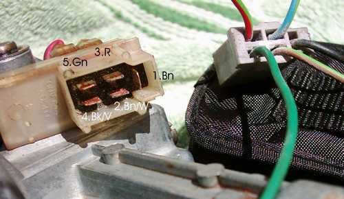

  20. I'm confused. The earth goes on Term.1, Parklink Term.2, (Connects to 31B1 on column switch) Park power Term.4, (a live 12v either constant or ignition live) Fast Term.3, (Connects to 53B on the column switch) Slow Term.5, (Connects to 53 on column switch) With the ignition on and wipers switched off and parked there should be zero volts at 1,2,3,5, but 12v at 4. The terminals are numbered as below in the pic. Note where the numbers are for the plug or the socket. One is a mirror image of the other. The only likely faults the park switch in the little white box on the motor could have are the contacts stuck together so that the motor gear cam cannot open them, or the said cam being missing. Either of these would cause constant running. You can check all the wire continuities. Previous post gave you all the switch continuities to check. Pic below. Ignore the printed on colours. They were sierra loom colours. The only live wire goes on terminal 4

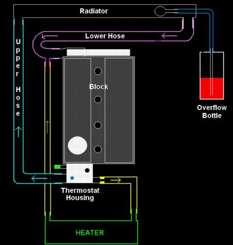

    This is mine. Includes warm-up bypass to reduce stress on the engine. Use the zetec thermostat housing if you can. This copes with 200bhp engine.
