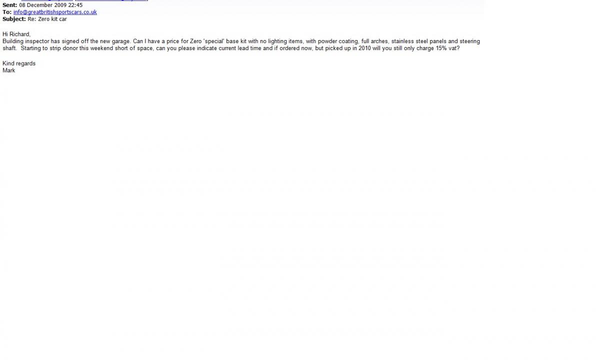

December 2009 - I visited GBS and asked Richard for a quote on the spec I want plus a few extra's and deletions from normal kit - if ordered by year the vat would not change. No chance still stripping and cleaning donor ancillaries.

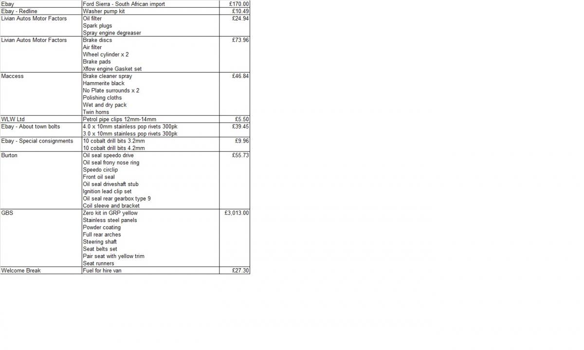

Cost so far;
(This is the last time I show the costs, without wife knowing the true cost of the entire build)

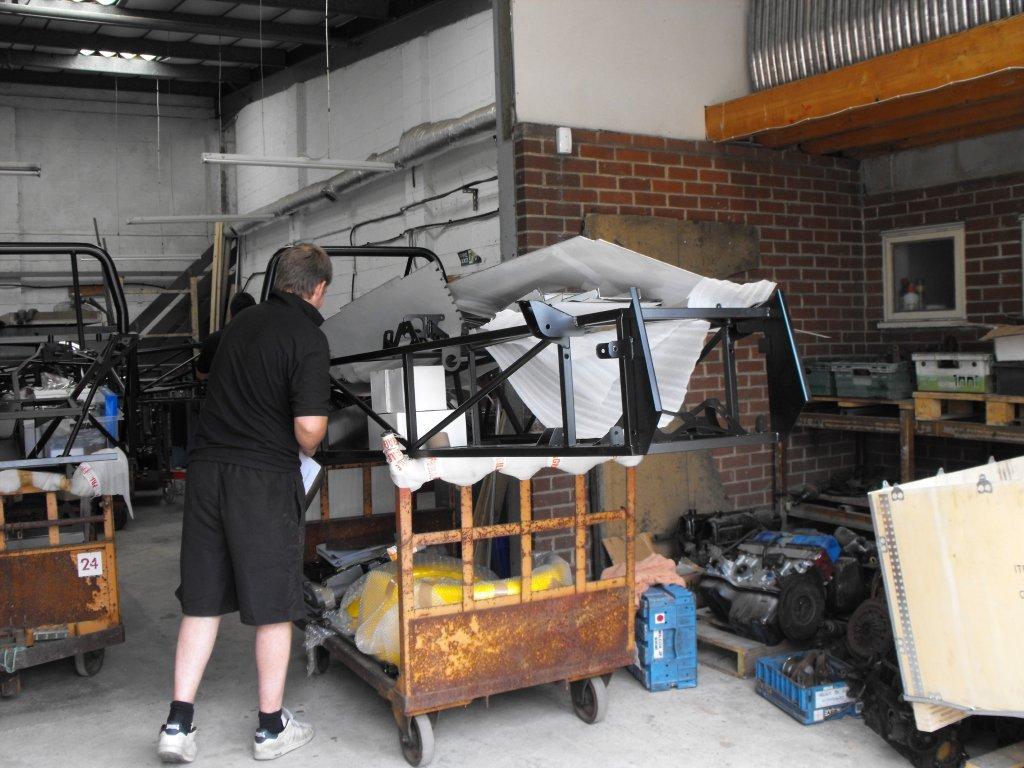

The big day arrived to pick up the kit from the GBS factory, 7th June 2010. My dad wanted to help, so he left Cardiff at 05.00 to travel to Telford. We both traveled to GBS in a long wheel base van, stopping at a real trucker layby for an all day English breakfast (heart attack in the making).
When we arrived Richard took us into the factory and workshop, (much more impressive now, with the show room) to show some new mods and future plans for the Zero. He then gave us a check sheet to ensure I was getting what I paid for. I was impressed with the process most of my car was pre-loaded onto a trolley.
Part by part we loaded the into the van.

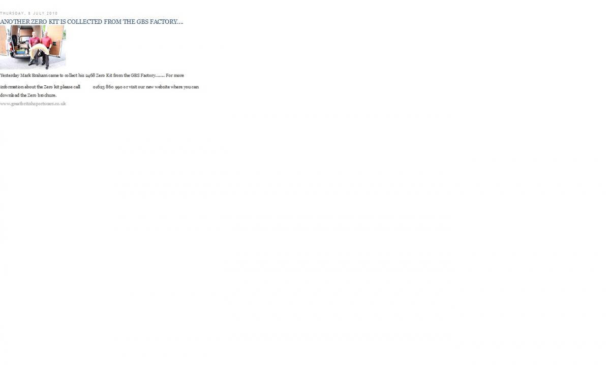

This was the picture that GBS used on their blog.
It was a long and exhausting day, but we managed to get back in time to unload the kit into the garage and return the van with no extra charges.

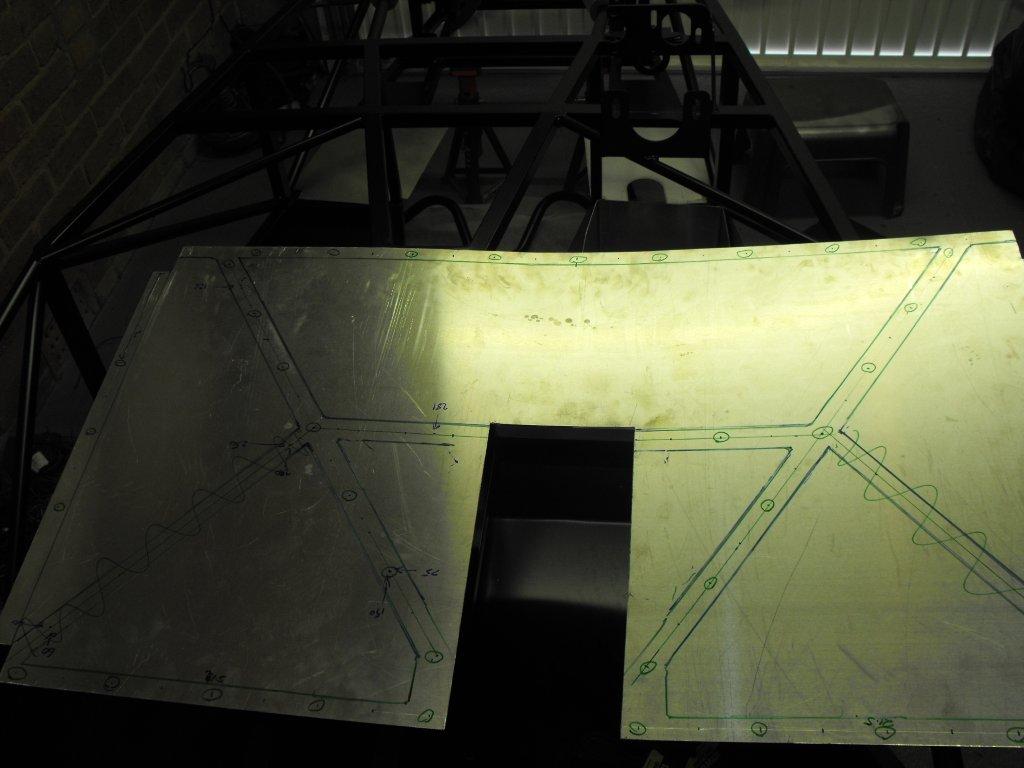

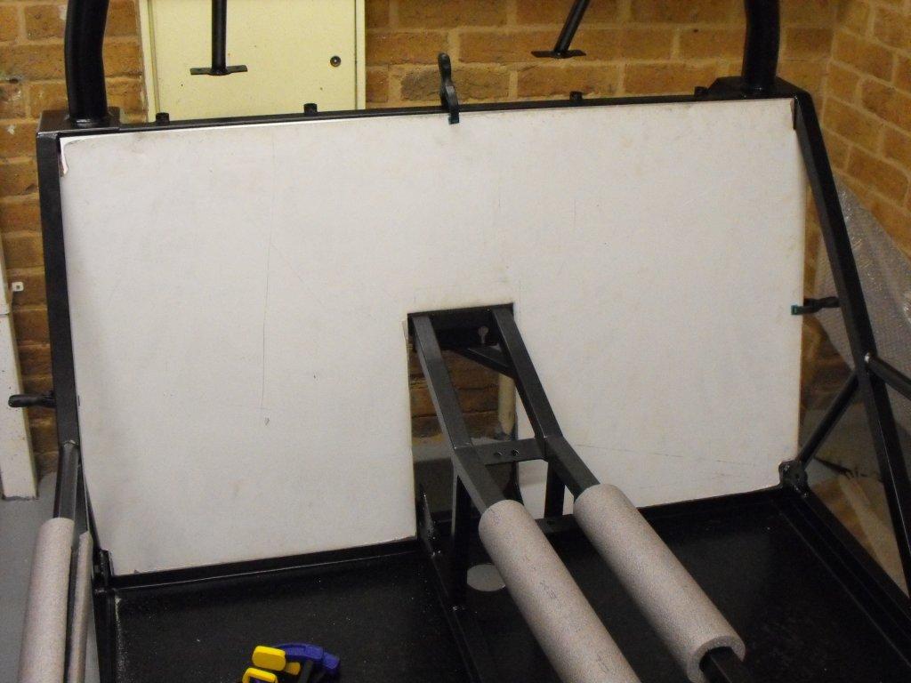

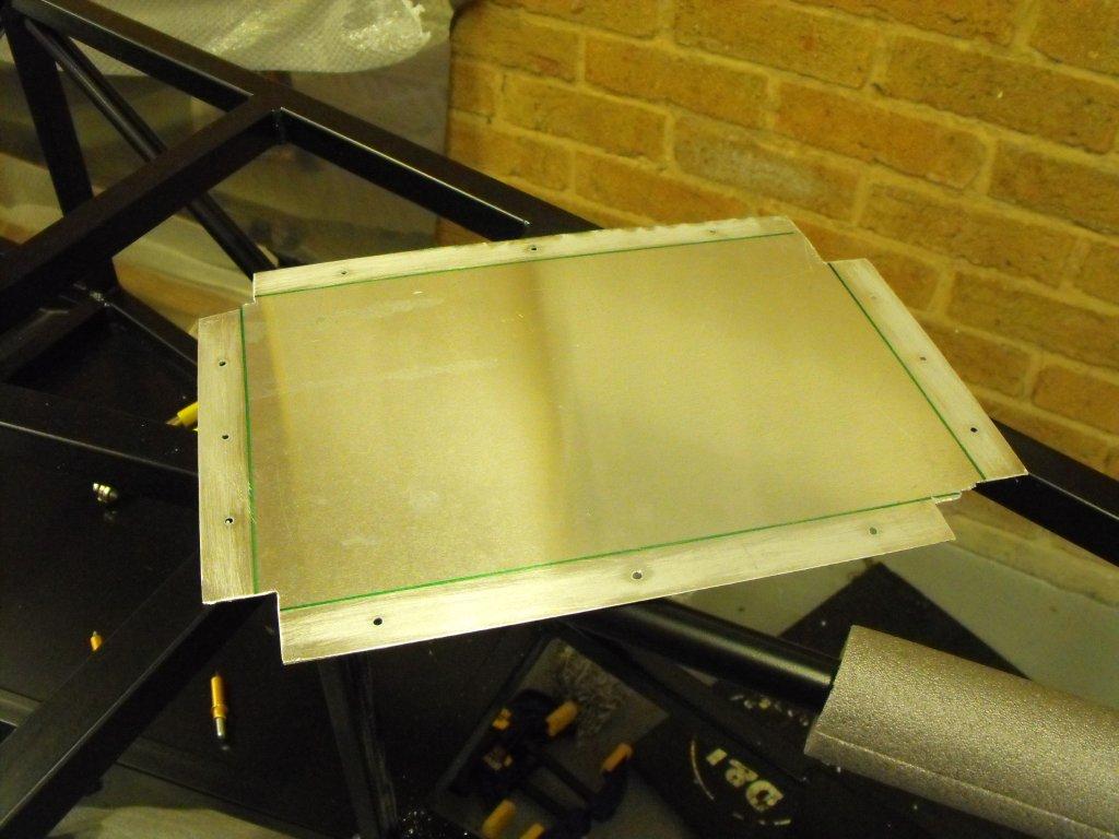

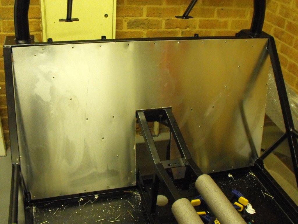

The first task I tackled was the back panel behind the seats. I had to trim some of the edges to fit the car exactly and to miss the welds.
Dry fit to ensure there would be no issues when using the drill and CBS polyurethane adhesive/sealant.
post-4145-0-85279700-1393179544_thumb.jpg post-4145-0-07707400-1393179607_thumb.jpg
I marked all the center lines and drilled the holes, before putting into place and marking the chassis.
All holes were cleaned and de-burred where necessary.
Finally with the aid of cleco tool and panel pins I fitted the panel with stainless steel rivets and adhesive.
First job done and happy.

Don't know how to best say this ----- that panel is back to front.
I have spent hours thinking about which way to put this panel on, well it was at least 4 cups of tea and a trip to B&Q for some more files, oh I might have had a hotdog from the Salmonella trailer. At least with the stainless steel panels they can only go on one way!

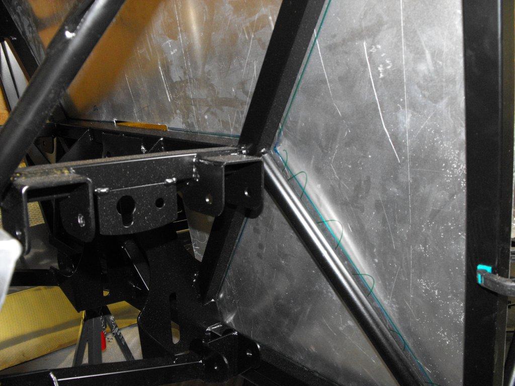

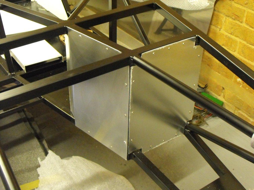

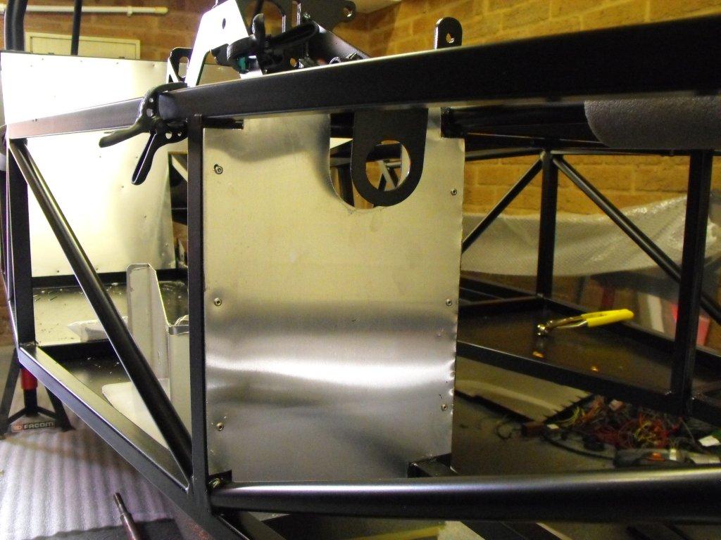

Next I started on the panels in the foot-well area, fitting was the same as the back panel. Dry fit, a little tweak here and there mainly to miss the welds and to remove sharps bits from GBS cutter.
I use some emery cloth to key the edges, before using the black adhesive/sealant (this stuff got every where).
post-4145-0-55484500-1393187146_thumb.jpg post-4145-0-97274500-1393187208_thumb.jpg
From advice on the forum I fitted the two panels by the gearbox bell housing on the outside of the chassis to give more room for the pedals and feet. Still tight and I have to remember not to wear big boots.
Looks ok to me Bob!
