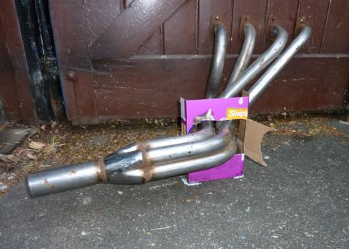

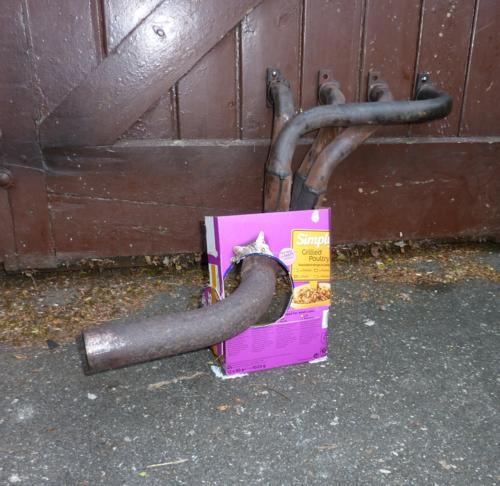

There are 2 possible problems changing from the RH 4:2:1 to their 4:1 manifold on a monocoque. Firstly the hole in the body side needs to be opened up forewards, I have a picture somewhere when I did it but can't find it at the moment. The next one, depending on the build the steering column may foul the manifold, I was lucky and it cleared. Fitting the manifold with the engine in place is tricky, it is possible by loosening the engine mounts and jacking up the engine to one side. The original manifold is not very efficient as the header lengths are all very different, the 4:1 is much better and sounds nicer. If you do a search on here you should find more information.

I have a 4-2-1 fitted but have aquired a 4-1 as 2nd pic of peters above but the down pipes have been slightly flattened to miss steering is it worth fitting in place or if sell whats it worth
