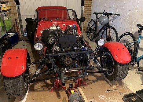

Hey, winter mods this year;
Front springs - going to 300lb from 250lb
Engine mounts - gone a bit soft
Cambelt - not sure of its age
Water pump housing - Thread stripped grrr
Header tank - going back to standard from a pretty allow one...
