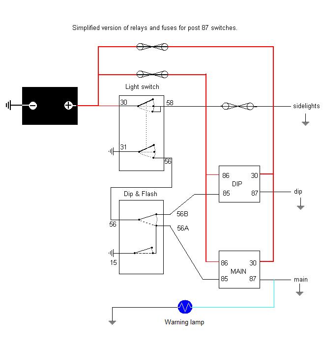

  1. Most later column switches are earth switching in the sierra. For reasons best known to themselves RH?RHE?GBS? did for a while change that but I don't know from when to when or what they do now.The pic below shows how they were in the sierra, switching in the negative circuit, but with the daytime function deleted. The important bit for the main beam warning light which should be common to whatever system is used is the 'supply' to the light should come off one of the main beam wires after it leaves the relay on its way to the headlamp.
  2. So blue main beam warning light never lights and main beam works off the column switch in normal mode but not for daytime flash. Two faults. Warning light takes its feed from one headlight wire after the relay. All later stalks use relays and most builders would have added relays for their early stalks too. Simple circuit to check. Wire from headlamp wire to warning light to earth. Flash not working means wire to terminal 15 not working. Check stalk to see if positive or negative switching.
  3. Sorry but I may have made a wrong assumption. I thought you meant the main beam and I assumed the main beam warning lamp worked OK with the normal lights on and dip/main switch operated but with lights off and just using the flash function you got no flash and no main beam warning light. If that is correct then it's the terminal left 15 wiring. Part numbers of the left column switch begining 83BG require constant live on 15. If later type beginning 87BG, 89BG or anything other than 83BG it's an earth. If that's not correct and I have not correctly described the symptoms correct me please.
  4. Tough call!
  5. Mainbeam flash has one unique wire not involved in the normal use/functions of the lights. On later post 87 stalks it's an earth on L column switch terminal 15. On 83 - 87 stalks it's a constant live to 15 on L column switch. If the lights function as normal in every other respect other than flash then its the wire on terminal 15 that has become faulty/lost//cut/disconnected/etc.

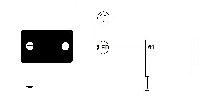

  14. The alternator is not producing for some reason. Duff or wired incorrectly?
  15. I melted a pair of toyo888s in one session. Had to drive home midday and get the build wheels with ditchfinder specials to run on. Two bodies in the boot and a passenger is about the best you can do in such a light and high torque car and it still probably won't be enough.
  16. Just goes to show an LED is not better than a tungsten in this situation. One way flow, sensitive to small voltage differences and may not allow enough flow to excite the alternator. Wiring a typical ignition light tungsten bulb in parallel with the LED should work. I can't guarantee the LED won't glow slightly even so, if there are any slightly high resistance wire joins in the circuits. Your right hand circuit is good. Nigel
  17. Can I ask what type, tungsten or LED, warning lights you are using and secondly which functions do you want to have? Please list them. If tungsten bulbs then it's all fairly logical as above. If LED then it's a bit different.

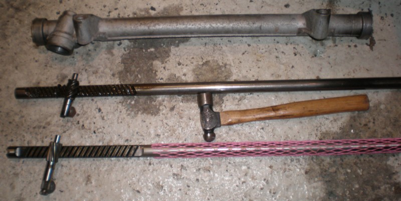

  22. Sorry. It was 2008 and I barely remember it. I have dug up an old pic below. I remember I had to use my old rack housing and just change the rack and pinion. Pic shows old and new innards and the housing. The pic reminds me the gear angles were opposite. I don't remember or see a step change in the diameter of the rack at any point either in the old one or the new. My copy of that pic is clearer at 1.5Mb but it's 'shrunk' to post on Rhocar. I'm pretty sure I just modified an old socket to undo the pressure slipper, pulled out the pinion then the old rack and the new rack just pushed straight in. I don't remember a struggle or problem. Hope that helps. Nigel
  23. Mines a quick rack from Rally Design. Very similar. Rack sticks out of it's housing by about two inches each side.
