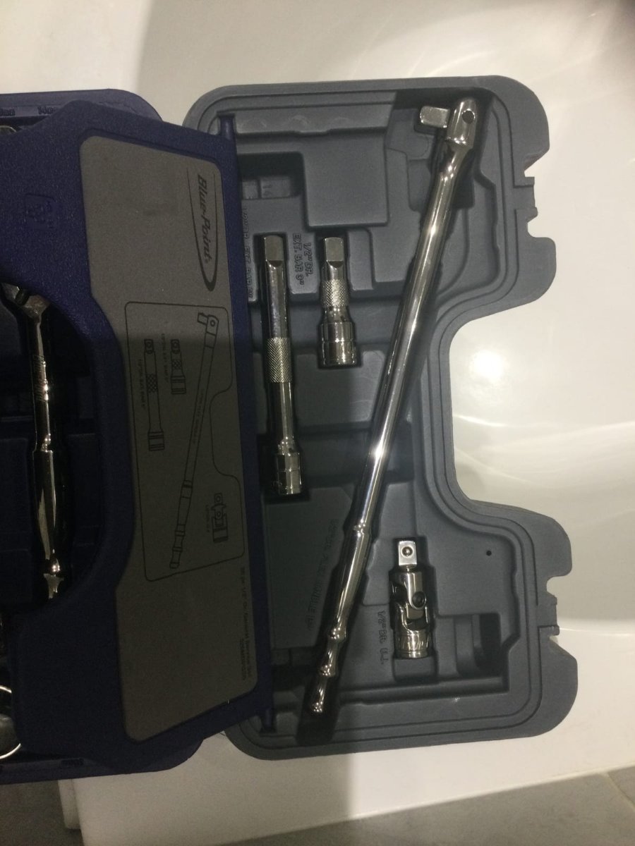

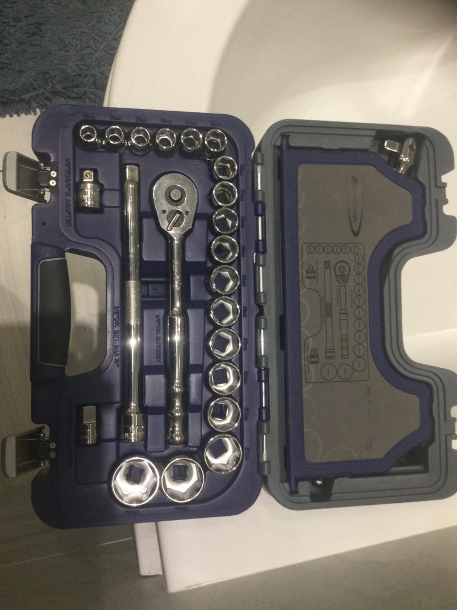

  2. Blue Point 26 piece 1/2" drive service socket set. Hardly any use so as new condition, a nice set but not really needed. £75 no offers. Collect from Tamworth or I'll post for £12.

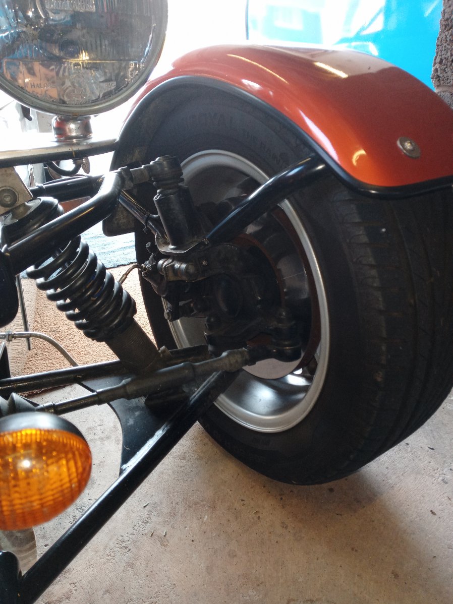

  22. Here's the pictures I promised. I'm posting them here is case it's any interest to others. The GBS wishbone handling pack https://www.kitspares.co.uk/index.php?route=product/product&path=43_40&product_id=539&car=43 is an upgrade for 2B's that already have double wishbones on the front so NOT the sub-k version. It comprises a new upper wishbone which moves the upper ball joint positions rearwards to improve castor together with a new dummy strut with wheelarch bracket welded on and this raises the position of the upper ball joint to remove bump steer. The wishbone mounts in the same place as the original one but you will probably find the wheelarch bracket tubes are in slightly different positions so if your current arches are bolted on, you might need to make adaptor plates to pick up in the original holes in the arches. I used some 3mm ally plate and some 20mm plastic conduit clamps. Pictures below is this kit on my car. The wishbone mountings are hidden inside some black fibreglass covers I made to cover the sharp edges for IVA.
