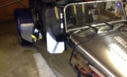

Cold right elbow seems to be inevitable
Fit wind deflectors. No more cold elbow and in fact I never use the doors any more either.
