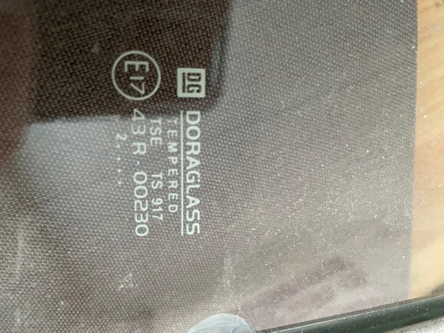

21 minutes ago, 2bTom said:
Will this pass?
Think so, got a spare?
24 minutes ago, 2bTom said:
Will this pass?
No, not according the IVA manual because it's missing the mandatory relevant marking shown in table 1 of Section 45. This would be I for a toughened (tempered screen). That said, mine passed with exactly the same screen so my examiner either had bad eyesight, or wasn't too bothered.
