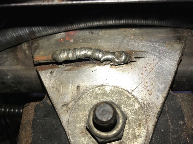

I've discovered that the front engine mounting plate on my Superspec chassis has a large crack. It's a large 3mm stainless steel triangular plate welded onto the front stainless chassis tube.  The crack needs welding closed and I'd like to get a reinforcing plate welded on top, as it looks like a repair has been attempted before by previous owner that's now failed.
I've asked at a few local places that do body and car repairs and light engineering, but no-one is interested. They say they don't/won't/can't weld stainless steel.
So what sort of place should I be looking for that is willing and able to weld stainless steel?  Anyone know anywhere in the Bedfordshire area?  I'd prefer a mobile service as I think I'm going to have to remove the radiator for access which makes driving anywhere difficult.

Welds exactly the same as mild steel, but with a different wire (and maybe different gas, not sure)... so quite why everyone is telling you that I don't know. Probably they just can't be bothered with a job that might come back on them if it fails again. I'll let the IWP (Internet Weld Police) comment on the quality of that previous repair!

Ideally you need it tig welding, which most body shops garages won't do or have the kit. I have mig welded stainless before with the right wire and gas but tig is better

That "weld" is just material laid on top of the crack, doing no good at all.  Have welded s/steel on Florin ( diff mounting ) & so far so good as not a trained welder.  If you have mig equipment have a go --- s/steel wire & argon gas does the job.  May not end up pretty but if you get more penetration than the last guy it will be a whole lot better, an extra piece of stainless welded over the top would make it belt & braces.

Cut the old plate off and replace with new steel. Each time you weld stainless you cause the other side of metal to oxidise, this is why it should be back purged.  This is why the repair has failed

Hi Ivan. Got your photo thanks. Interesting that your bracket split on the vertical part of the plate below the cross tube, whereas mine is going on the horizontal bit before it wraps round the tube. The plate is obviously not strong enough to take the loads, or else the two horizontal and vertical mounting bolts on the engine mount are not well aligned and put the bracket under strain. My bracket has been bent to fit. Did you make your extra bracket out of stainless?

Hi Kev, yes it does look bodged even to my inexpert eye and not surprising it failed. Im quite willing to cut the old L shaped bracket off completely, and I could get some stainless to make a new one, but I will still need someone to weld it on for me.

cant remember what material i used but same thickness of original and just about 1.5 inch wide bent and drilled to match the two fixing points done about 700 mile and still holding up but at least i now know where to keep an eye on it. as per photo you can see how bad mine was and i dont know how long it had been like that as ionly found out when i removed the radiator
