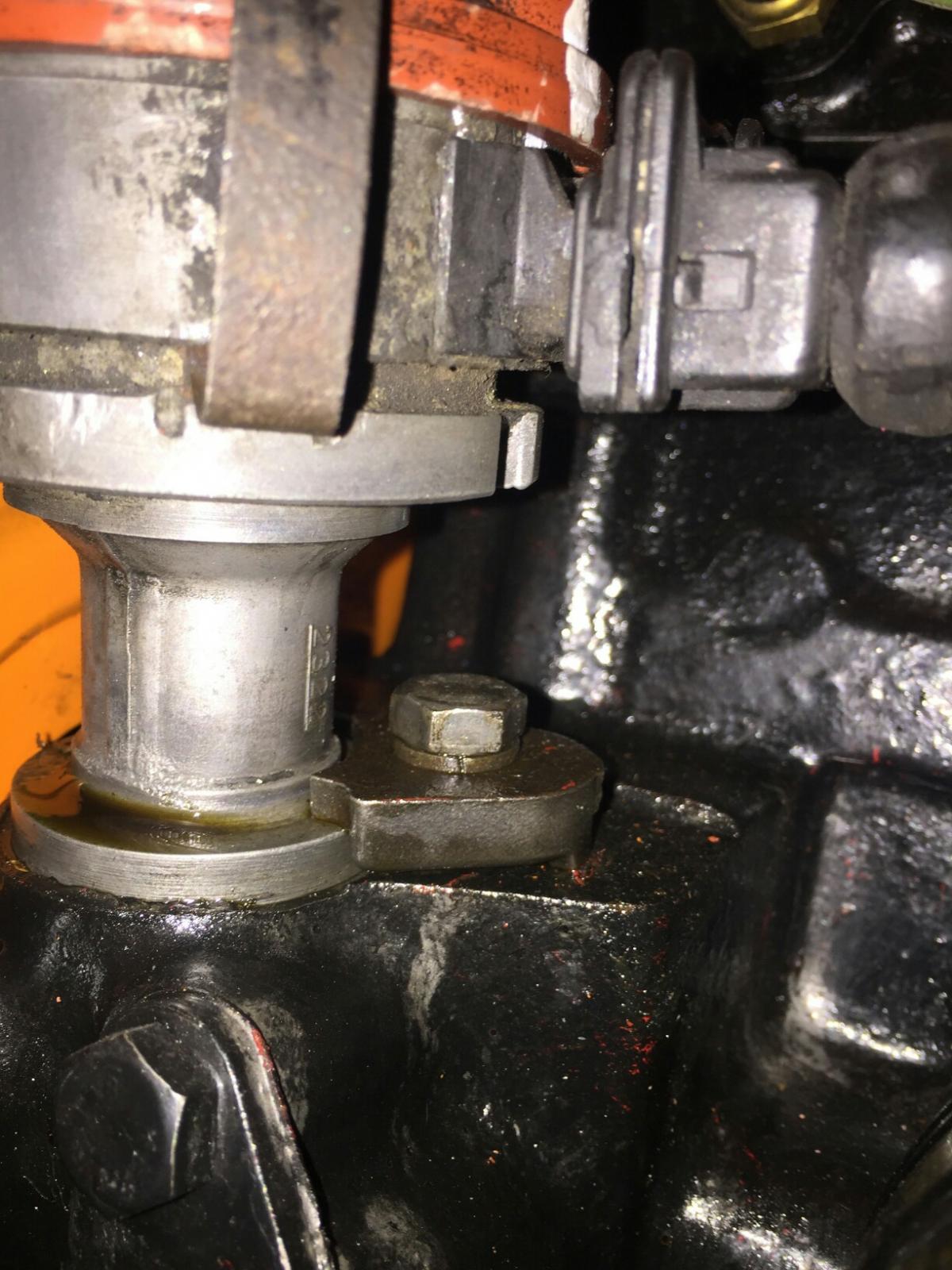

File 11, oil under tge dizzy

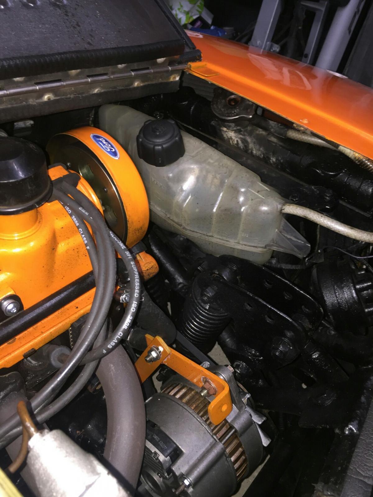

File 3, view across bay
If it was mine, that header tank would have to go and something different and less obstructive, it's blocking half the radiator! i also think that is the old 'Cortina' type radiator, it's definitely only single cored.
The oil around the dizzy may not be coming from there, but from the rocker cover and running down, there may be a problem with the engine breathing, especially as it's been overheating. You need someone to have a look at it that knows what they're talking about.
As an aside, you have an interesting front suspension layout with a rocker arm, very unusual. It doesn't help your problem though but hopefully someone nearby will be able to lend a hand with some basic checks.
Not sure if that is a header tank is may be just an overflow tank for the spit and suck system, there is a good explanation of pinto cooling on Dave Andrews old site http://dvandrews.co.uk/ look at the oil and water control section.

There is now a small oil leak under the dizzy. The coolant obviously evapirated!, left spray marks on the engine!
