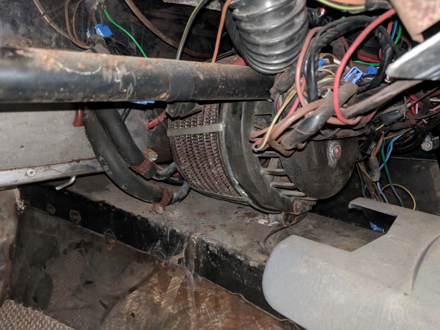

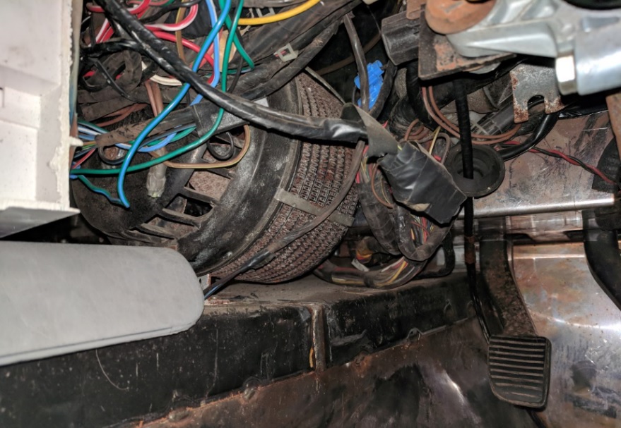

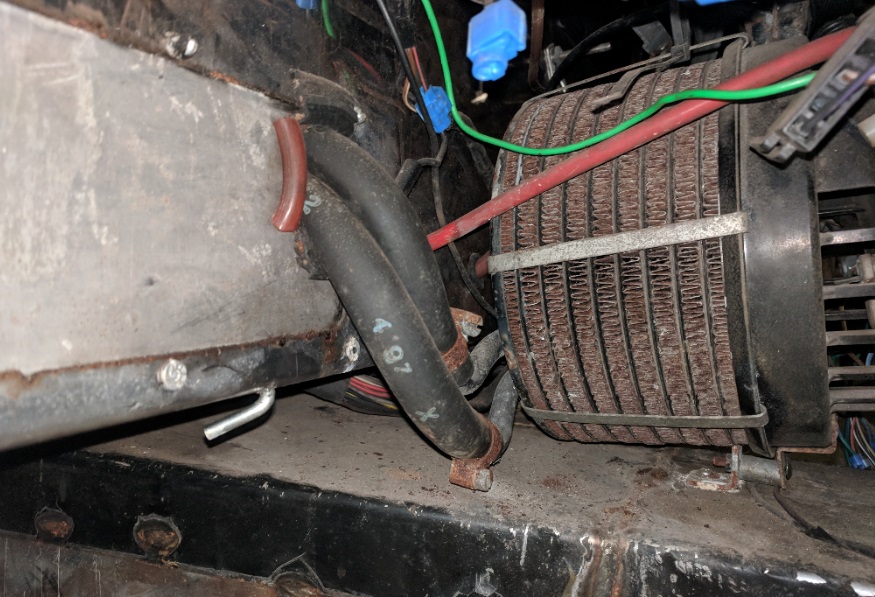

And finally for Dave Ed here are the pictures you wanted of the heating assembly, hope this helps, will be happy to answer any questions you have.

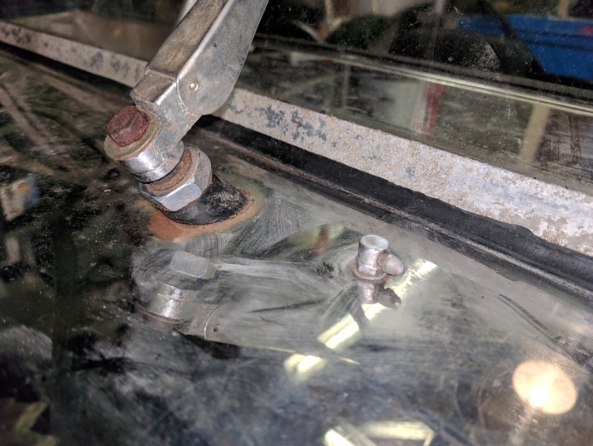

Also a quick question. I am assuming these wiper arms and spray nozzles wont pass IVA?
Correct - the wipers are just missing the nut covers, but the nozzles certainly won't assuming they are contactable by the test sphere, which is almost certainly a definite. Cheap and easy-enough swap ;)

Thanks for the heater pics. Ive got a mini heater that Im looking to squeeze in the same place once Ive moved some loom.

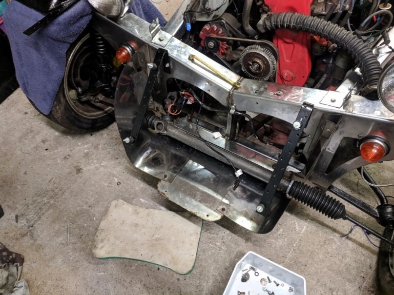

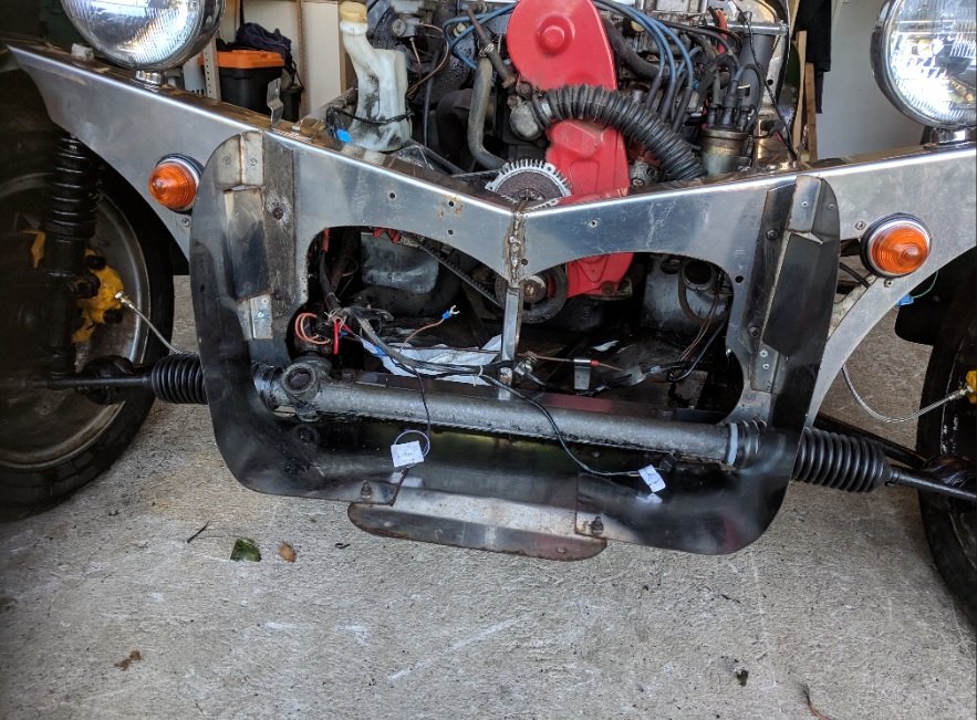

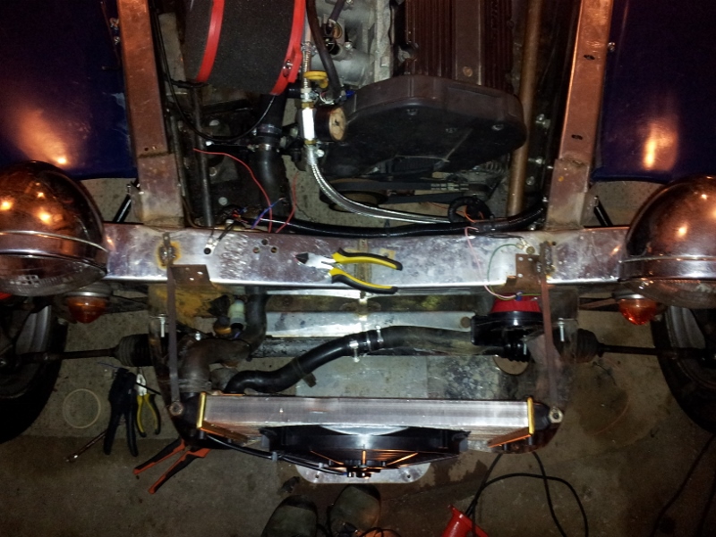

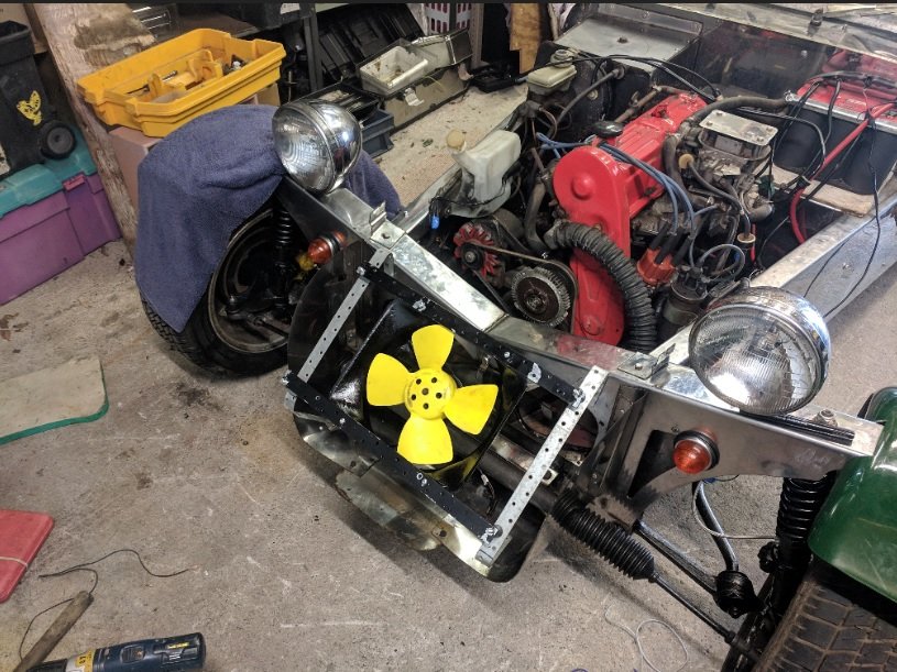

So after finishing the radiator weeks ago we have decided, after advisement, to move it into the nose cone for better cooling performance. This meant I had to dismantle the entire font of the car, something it seems the previous owner never planned to do as there were a lot of rivets holding it on. Fortunately the front came off quickly after a bit of swearing and the liberal use of an angle grinder.
I have also taken out the front fog lights, horn and the extra electric cooling fan the previous owner added in the nose cone. I'm assuming the extra fan was probably his way of trying to improve the cooling. I'm going to move the horn behind the radiator, leave the fog lights out (cheers Peter) and add a thermostat controlled electric fan on the radiator (having already removed the fan off the front of the engine). As I was dismantling things I also decided to rip out the old interior ready to start measuring up for the new one.

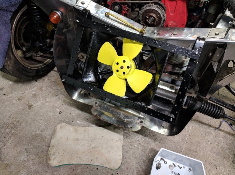

So now everything had been taken off and prepared its time to fabricate some brackets for the Radiator and get it all put back together. That's today's job so once that's done I can get back to the electronics, interior and IVA prep.

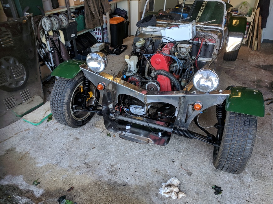

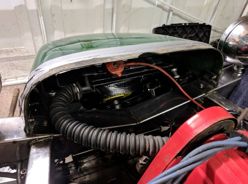

Here is a few pics of the front without the radiator.

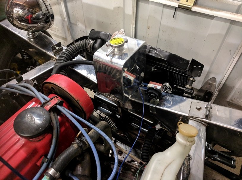

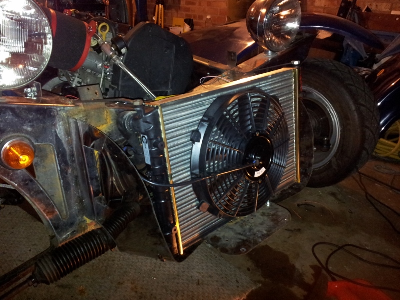

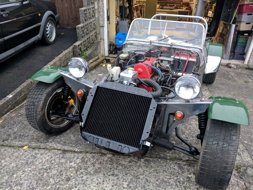

So moving the radiator took a lot longer than expected, as you all know its a pretty tight space for such a big object. Luckily we were able to use our current radiator and just mount it at an angle in the nose cone. As we removed the fan off the engine we have instead mounted a fan behind the radiator sucking air through it and fitted a variable thermostat to control the engine temps.  I will attach a few photos of all of this below.
One thing we noticed is that because the radiator has been moved it now sits below the engine so we have had to add in a header tank into the loop as well, not a difficult job and I actually like the way it looks in the engine bay.
Other than the radiator we have done a few other little bits like adding the new chrome trim to the bonnet, fitting the IVA approved bonnet catches, ripping out the old interior and starting to fault find the electronics.
Until next time here are some pics to keep you interested.

Looking good. You can give yourself a massive cooling boost if you  make some blanking panels that extend from the edges of the radiator forwards to the inside of the nose cone. This will ensure as much air as possibly goes through the rad when you're moving, rather than spilling around the sides.
