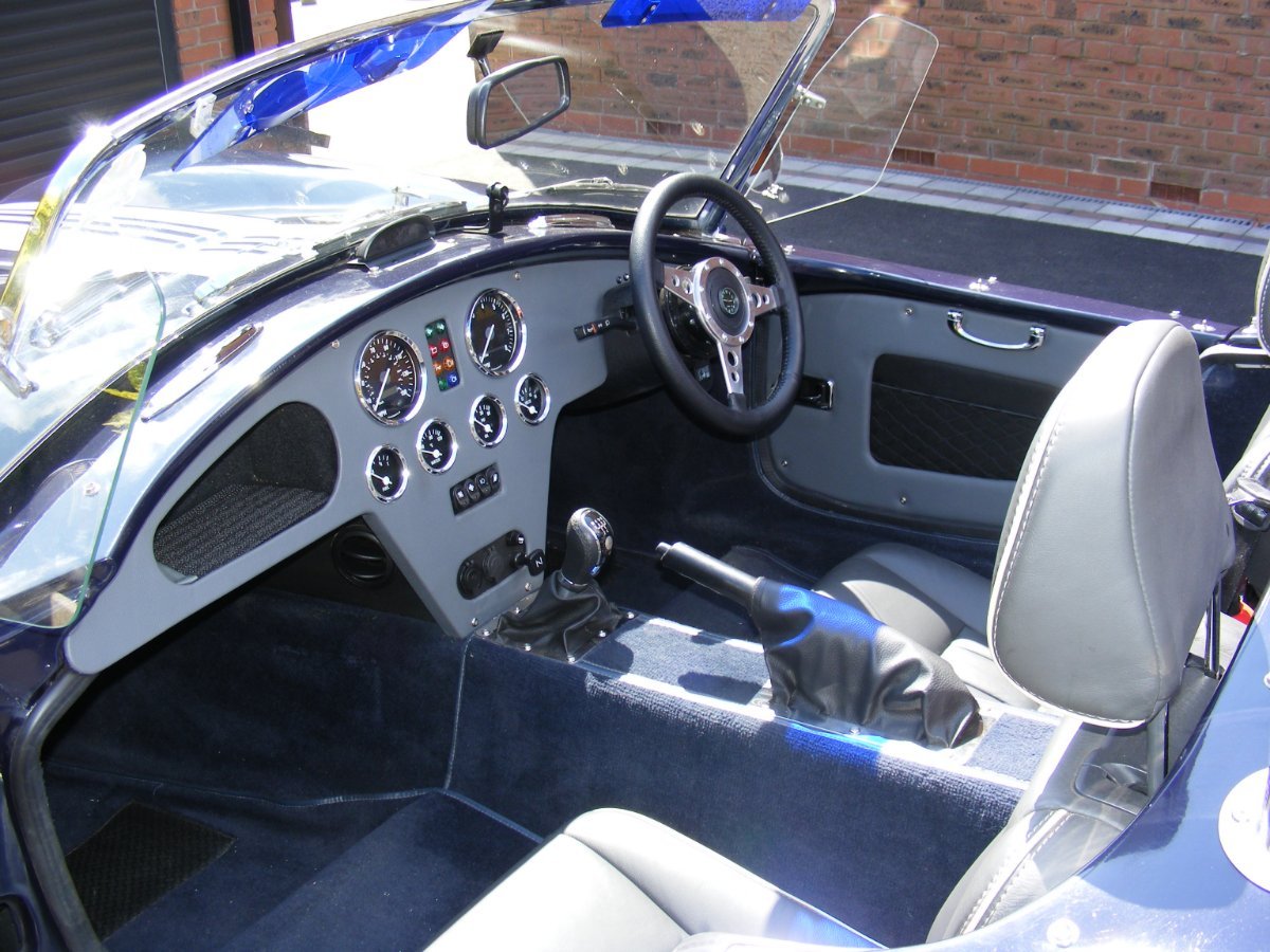

  11. I don't know if this will help or confuse but here's a photo of the dash I made for the Cobra.
