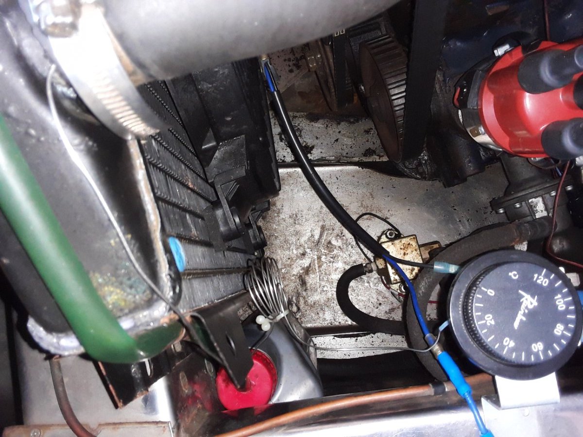

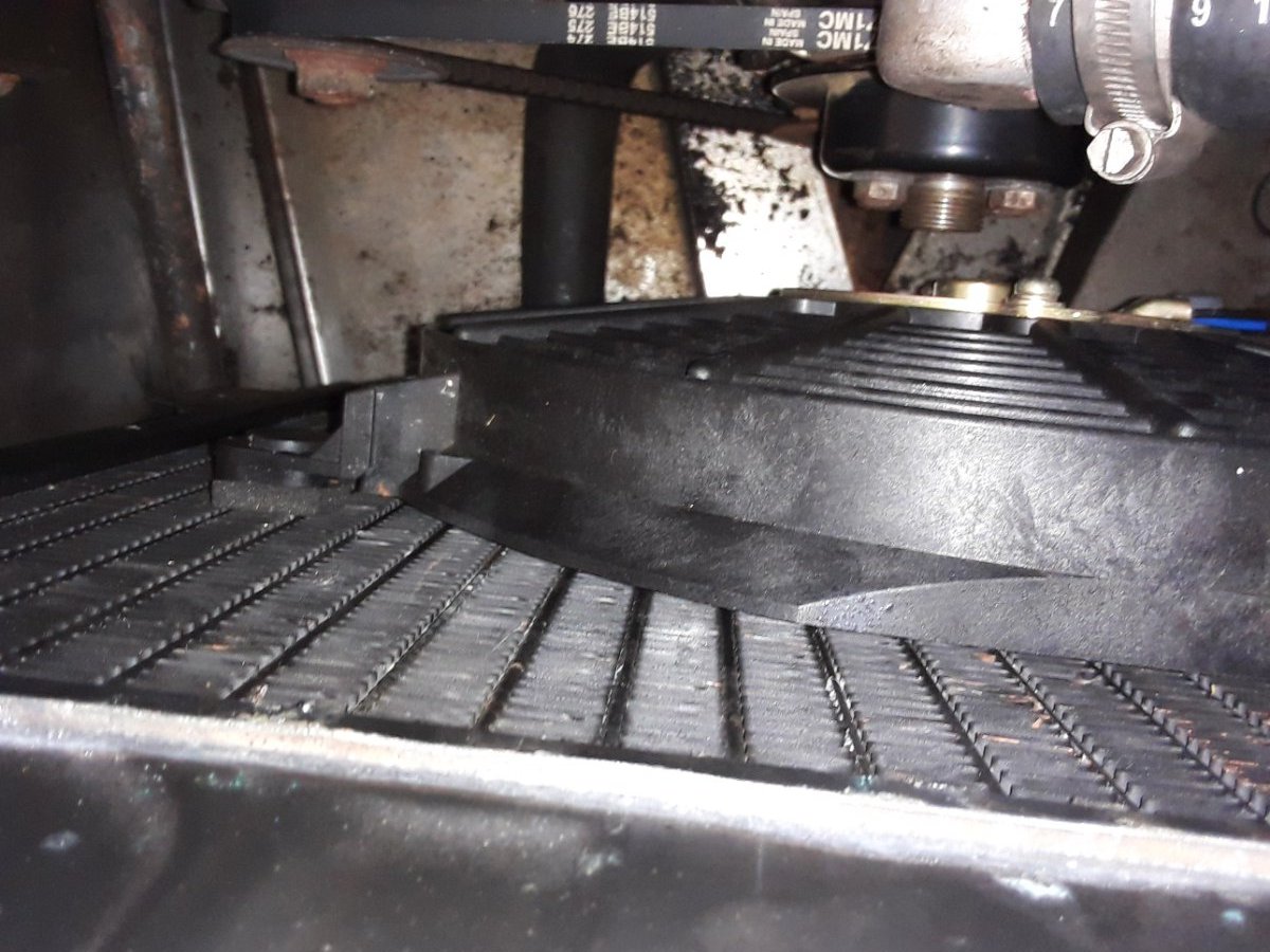

  15. IanS
    Radiator issue..
    You wanted images. This is my setup, the fan is about 5mm off the rad core and pulls the air through. There are no vents in the bonnet the air goes out through the floor past the engine or down the transmission tunnel. I put the engine straight into the kit from the doner, it overheated all the time so I removed the thermostat which did nothing for the overheating. So I used Holts speedflush and an amaising amount off crap came out and now I ran cold except when stuck in stopped traffic. So I refitted the thermostat, removed the viscous fan (you can still see the screw thread on the water pump) and fitted the electric fan shown with a thermostatic switch and now run at normal temperature all the time. The engine is a 2l pinto with the doner dgas32/38 carb so gives about 100hp.

  21. IanS
    Radiator issue..
    I used similar to this to mount the fan direct to the rad. https://www.carbuilder.com/uk/fan-mount-kit-with-assorted-feet I also used https://www.carbuilder.com/uk/adjustable-fan-controller-thermostat to control the fan, fitted to the top hose. The bulb is in the top hose and feeds in through the joint between the top hose and the rad. You can probably get these cheeper on amazon/ebay. For the MOT just leave the switch on untill you can update. I removed the viscous fan as it does very little and most are actually dead as they were not long lived in the original fitment.
