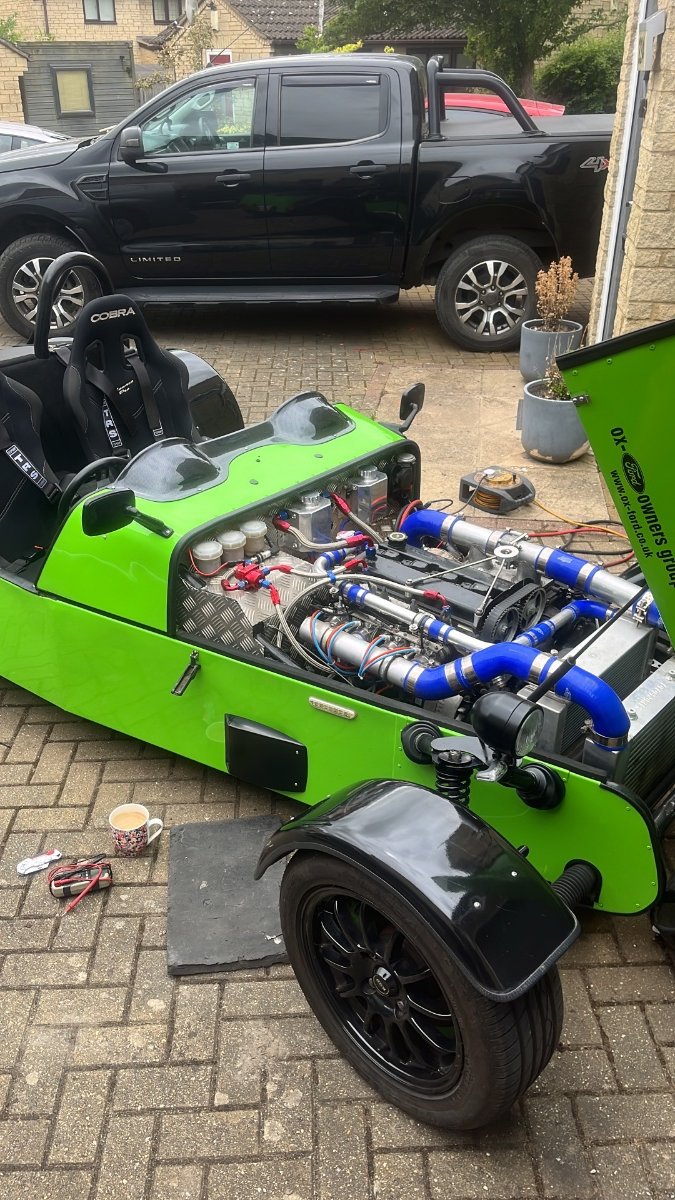

If it was me I would have kicked that cup of tea over within seconds of putting it down There is a good chance that the engine had it's compression reduced in some way - head spacer, thicker head gasket or similar when the supercharger was fitted. If so you would really need to put it back to standard if you removed the supercharger. I would imagine it would be easy to re-map the ecu but I don't know enough to help there - hopefully someone else can give you some info. on that. It might be worth explaining exactly what problems you're having with it and seeing if anybody knows of any easy fixes ............. if there ever are such things.
Hi new member here although i was a member s few years ago in hoping i can get sone advice I recently bought myself another robin hood its fitted with a 2 litre zetec which has a supercharger fitted im having a lot of trouble tuning it its fitted with a microsquirt ecu is it a simple enoigh job to remove the supercharger and remap the microsquirt ? And use it as an efi ?
