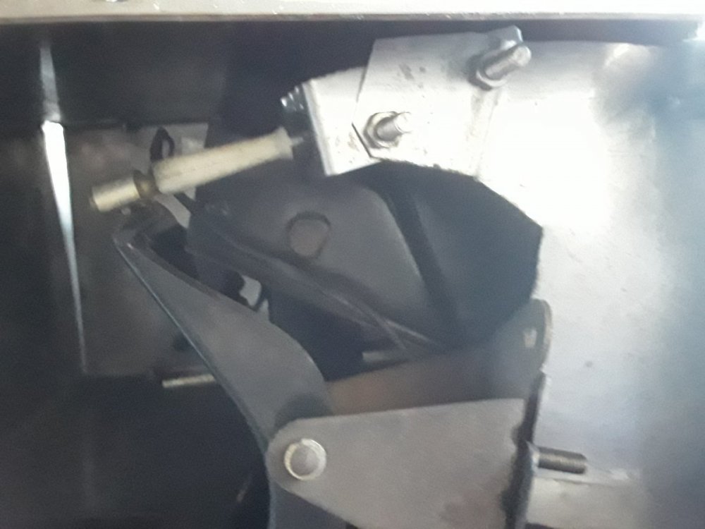

  15. In short I drilled a new hole and used the pedal unmodified.

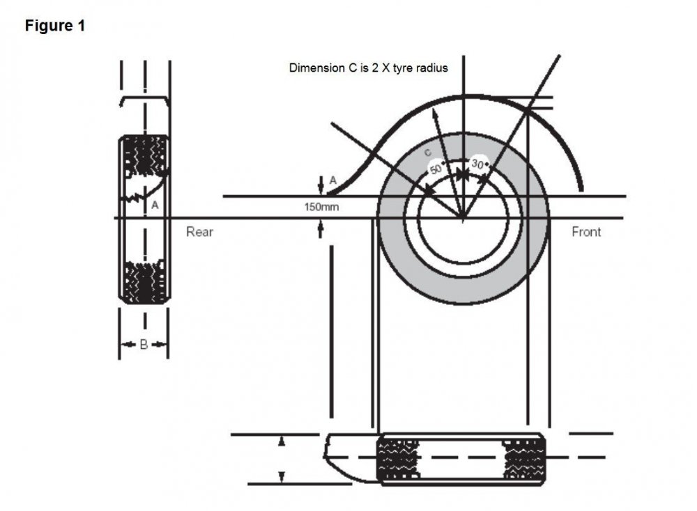

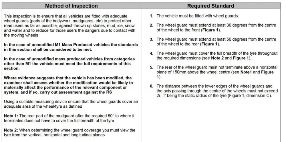

  19. Looking at the IVA requirements you are covered. screenshots from IVA manual. See note 1
