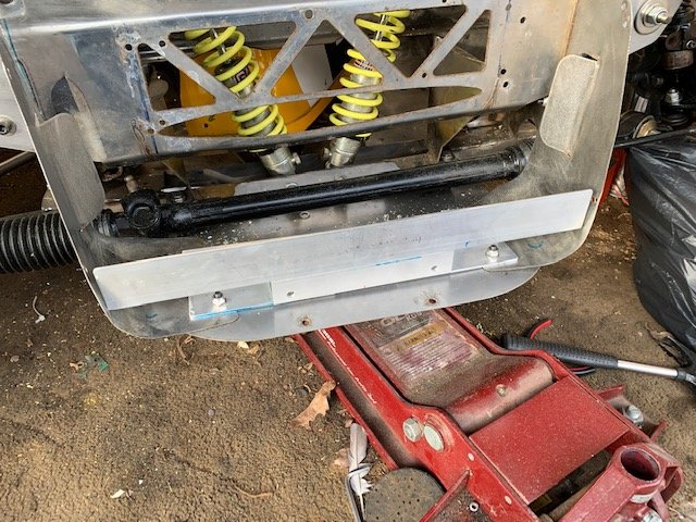

It’s 100% a brace, probably part of mounting the seats. But having it as the lowest point on the car is the issue. Will make a flat plate to reinforce the weak/damaged spots

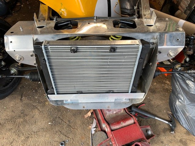

Lots of tin tops have sidesways rads.
Admittedly most are a lot wider than tall so it possibaly is need for uniform heat disipation reasons.
Mine's  the same design as that one.  I think it's based on the VW Polo.  Being an aluminium radiator I was told by the supplier (Radtec) to mount it on flexible rubber bobbin mounts and to only use the old style antifreeze with it.  Apparently they have had failures at the matrix joints with the newer antifreezes
That’s helpful to know, I’m going to fabricate a new mounting system and integrate some rubber mountings for sure.

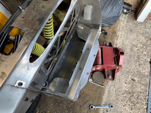

The next move was to fabricate new brackets for all the front panels, the rad cowling and front nose. This is all absolutely solid now - with the new rad being nearly fitted.

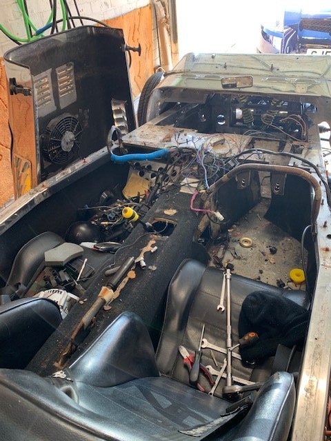

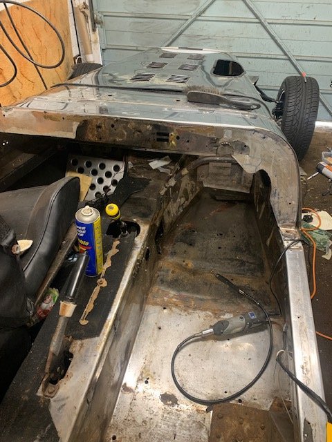

I have also decided to strip out all the rats-nest wiring and damp and rotten interior - with a new Autosparks loom ready to go back in.
Whilst doing this I have also going to fabricate a better column mount/front roll hoop as frankly what's there is bloody dangerous. I am also doing away with the column switches and cowling - this will be a stripped down raw experience!
