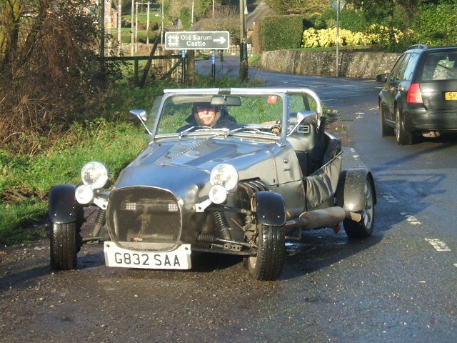

Have always just used a soft "door" on Florin. 4 fixed points -- screen base - roll-bar base & 2 below level of side panel top. Strong "knicker elastic" inside a sheet of light weight tent material for the "door" on both passenger & drivers side. We also have a surrey top so only the side "window" part is still open. These two fold up & live in the glove box when not needed, but usually stay on the car most times. Has been O.K on thousands of miles in some very poor weather, generally get a little wet if a strong cross wind drives the rain in. We keep warm with the foot well heater & a blanket in frosty conditions ( plus scarf/gloves/Biggles flying helmet/leather coat)
Bent Florin's rear end around my MIG gas bottle as it was nearest undersize "tube" I had. If bent around your knee ( or any other part of your anatomy ) it will create a threepenny bit shape of several small bends. Suggest the centre of the chassis is found with a straight edge marking where the tube finishes touching it & dividing in two, transfer this to the panel centre & the finish of straight marks will give the start of bend, which will need to be over-bent to allow for spring back of the metal. Check earlier recent post which also dealt with this panel.
Good idea Bob, my worms can't be supported by pics, took far too few during build & it was a decade ago.
Bob above is not wrong, but we have Florin's side panels with a top/bottom curve -- achieved with lots of sash clamps & additional shaped metal/rubber support behind. As said Florin is a one off as I didn't like the idea of flat slab like sides so drank tea & thought lots before fixing them with a crescent.
Florin has two 50 x 25 m/s channels welded between the round chassis tube ( under your knees & across car ) & the rear join between floorpan & seat back panel, which also has a re-enforcing metal section across the car.
May not be much help but here goes ---- on our 2B we cut the back panel ( one behind seats ) in half & fitted each side correctly ?? then riveted the overlap together. The side panels ( 8 feet long ones ) are too big for the over-all space between top & bottom chassis rails --- we bowed the panel length wise to make the top & bottom return touch the chassis. Made a bowed bracket to suit, which also carries the front fixed to flexi brake line. The rear panel for the very back of body work was bent by wrapping it around my MIG gas bottle as that was the best radius item I could find at the time, the top lip needs very careful thought ( at least a few teas/coffees ) as it needs to be shrunk to fit the chassis rails OR can be left standing & covered with the fibreglass "boot lid" supplied. Above maybe useless --- Florin is probably a one off 2B
